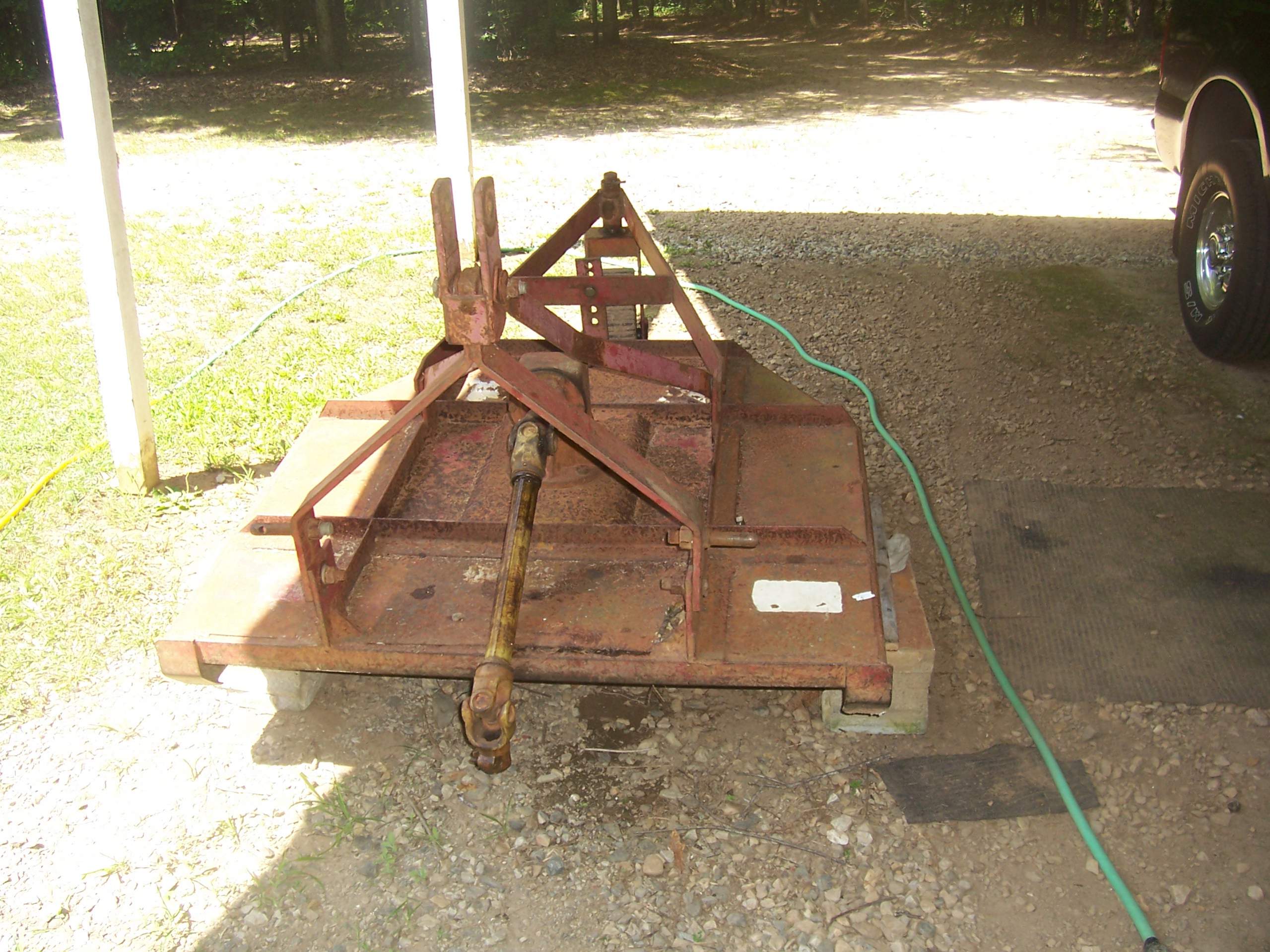

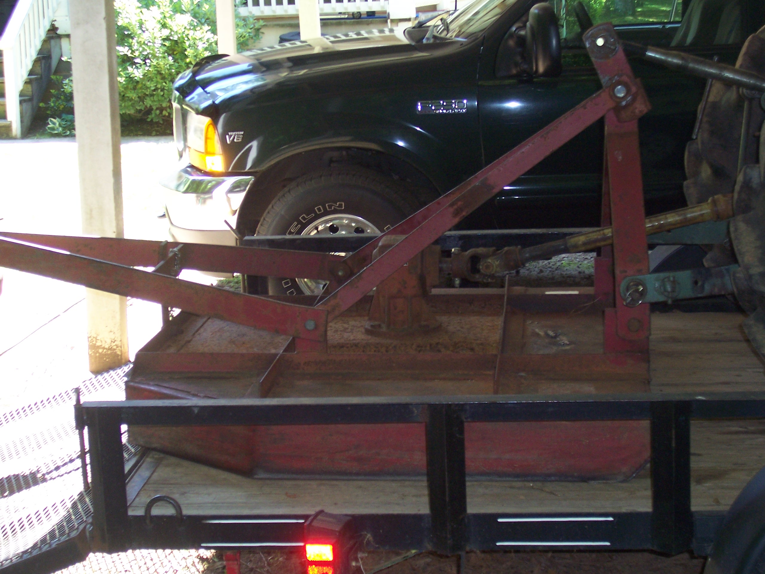

If we use clemsonfor's number of 1430lbs at the tip of the lower link and assume that point (the lower 3PT lift arm pin) is 2' from the rotation point (the axle that it rotates around) that gives 2860ft-lbs of torque. If that's the max torque available, it would lift something 500lbs if it were as far away as ~5.75' (2860ft-lbs/500lbs). From this 5.75' we need to remove the 2' for the length of the existing lift arm leaving 3.75'. So if my BH weights 500lbs and that center of mass were placed 3.75' BEYOND the lift points it should just barely lift it.
If it weights 600lbs that distance drops to ~2.75' BEYOND the lift pins. As a rotary cutter it's fairly symmetric about the cutter spindle so I think it's not a bad assumption to view the gear box as the center of mass. I'm not near the BH but given that it cuts 5', the blade has to be something close to 2.5'. I'd say the distance from the mounting pins to the center of mass/gear box is under 3'.
I think this tractor should be able to lift a 600lbs where the gear box is 2.5' beyond the attachment pins. It's not a wide margin, but I still think it should work. We've also got clemsonfor's heavier finish mower (when he's standing on it) and duanew1's BH (which looks about like mine) as evidence of strong lifts. Although he didn't say anything about lifting with his weight added to it, when duanew1 climbs onto his BH it doesn't appear to drop.
