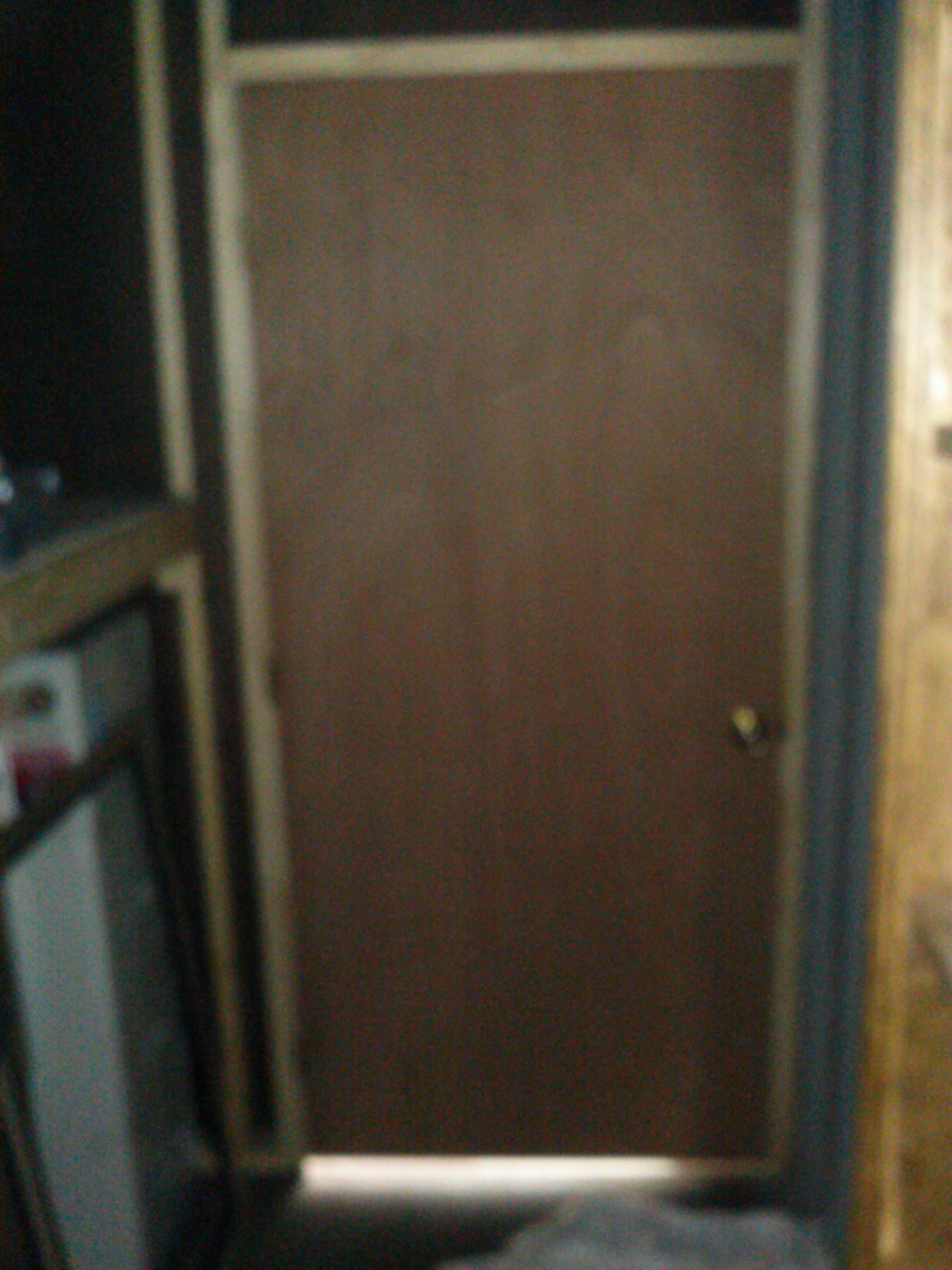

Today was a busy one! We built a shelf in the storage section, about 16 x 4 and 4.5 feet high. You can only stack boxes so high, so this allows me to stack to the roof.
Also, got the interior wall done, Next-- an entry door.

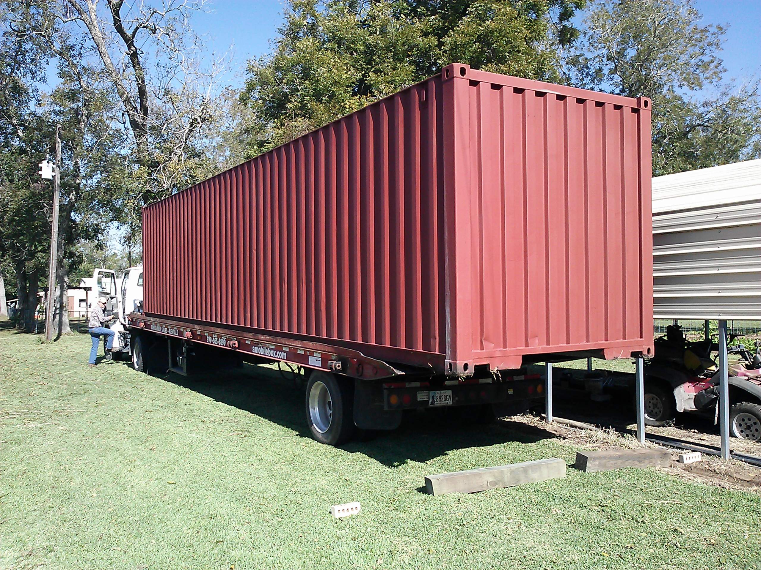

What color is the outside of the container? That might make a significant difference to heat gain.
I think in this situation I might have been tempted to track down a small (used) travel trailer to live in and use the whole storage container for storage.

The sides are dark brown, top is silver/white.
