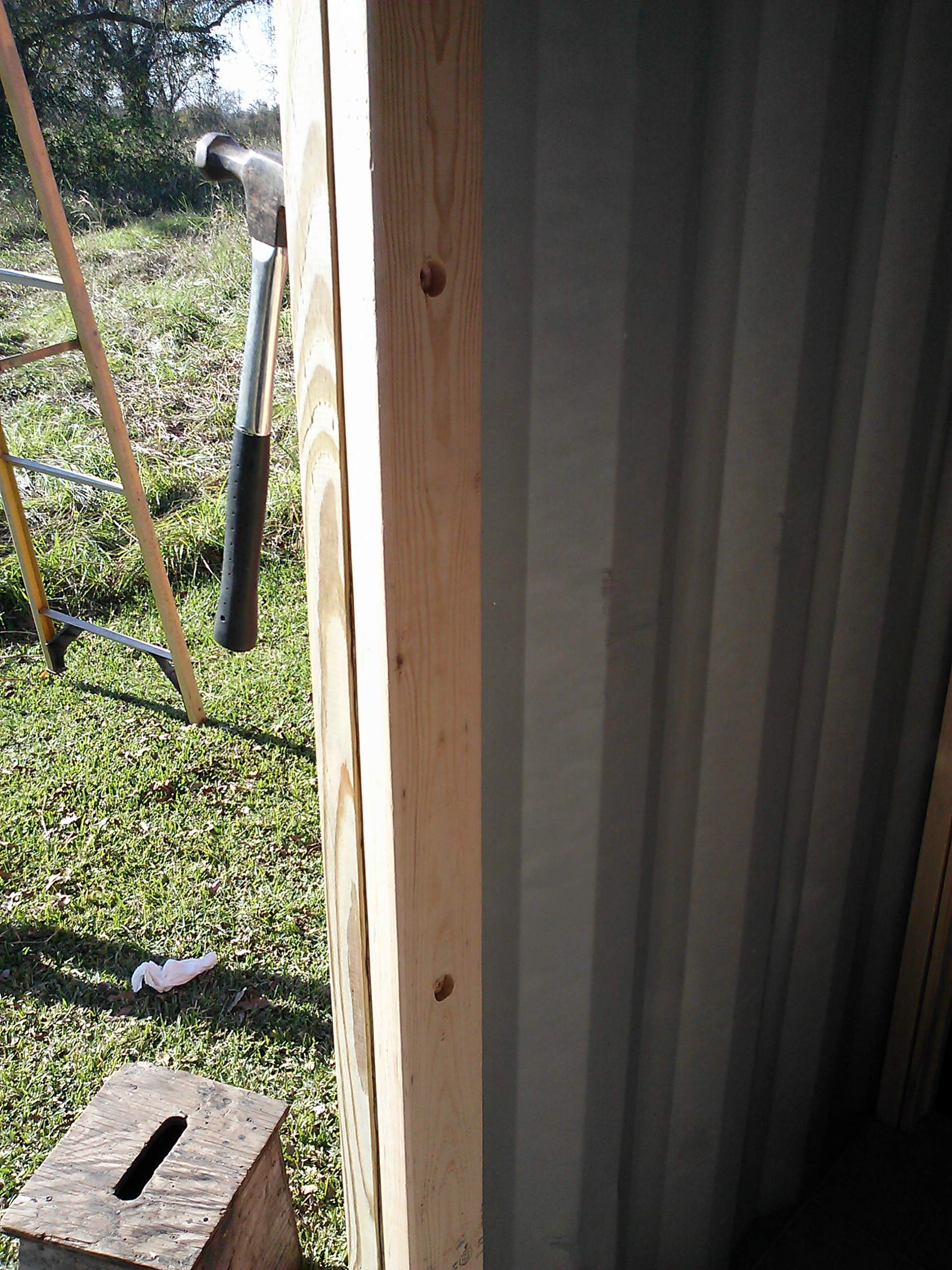

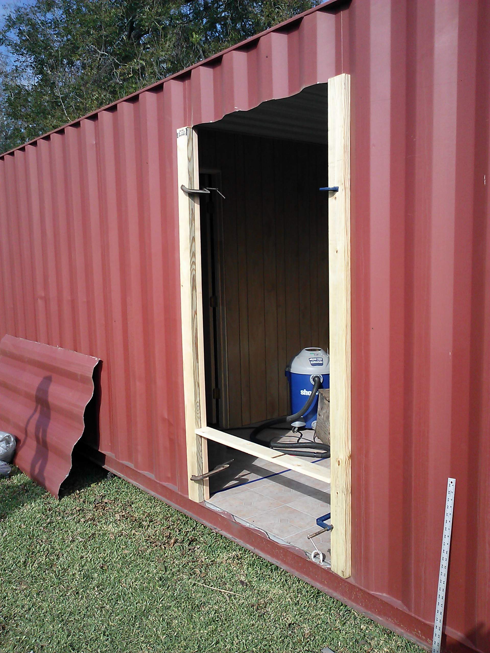

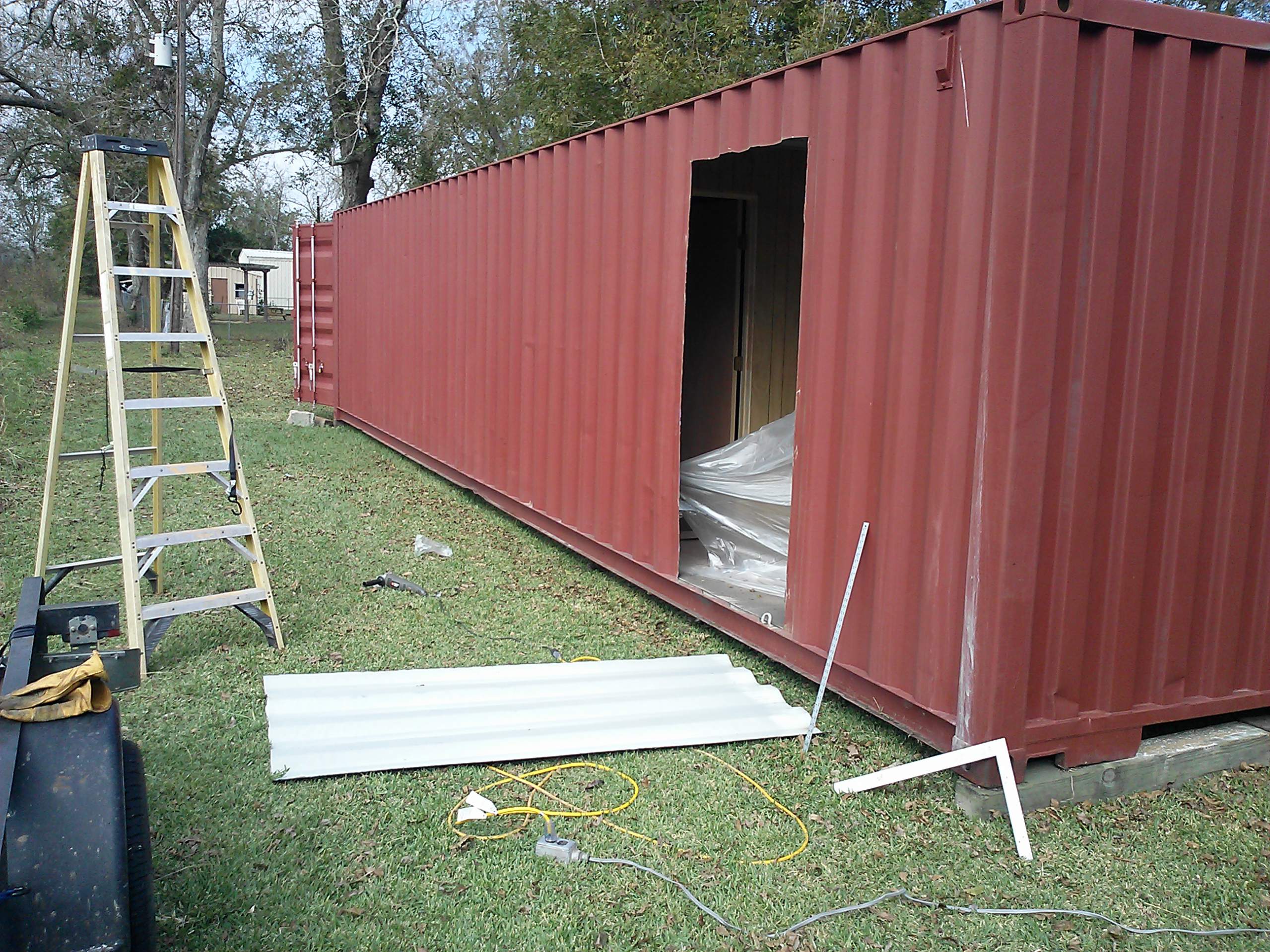

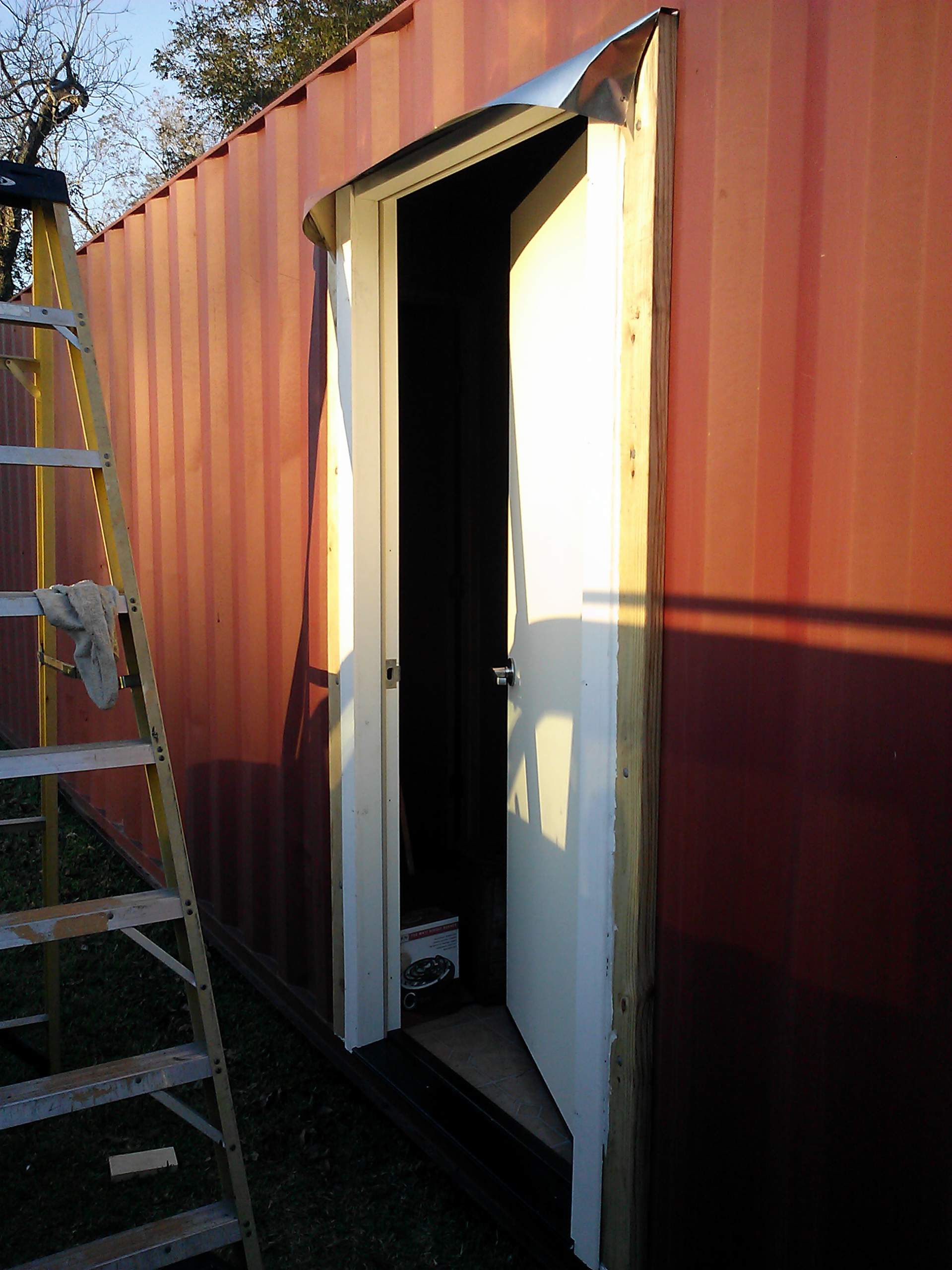

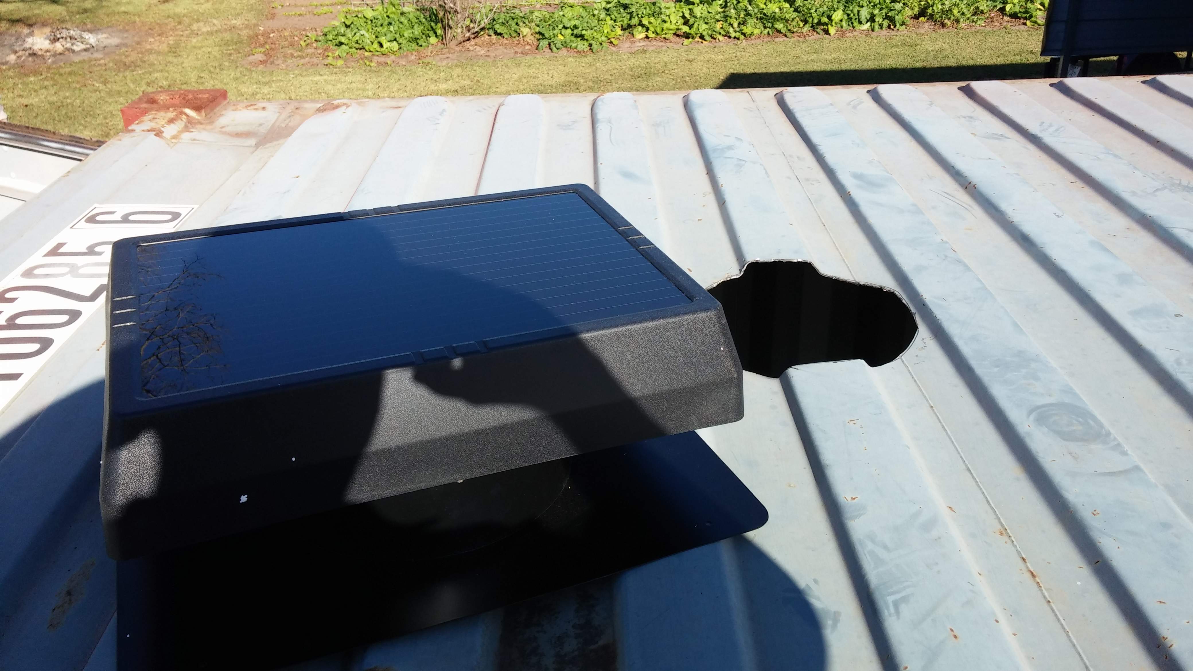

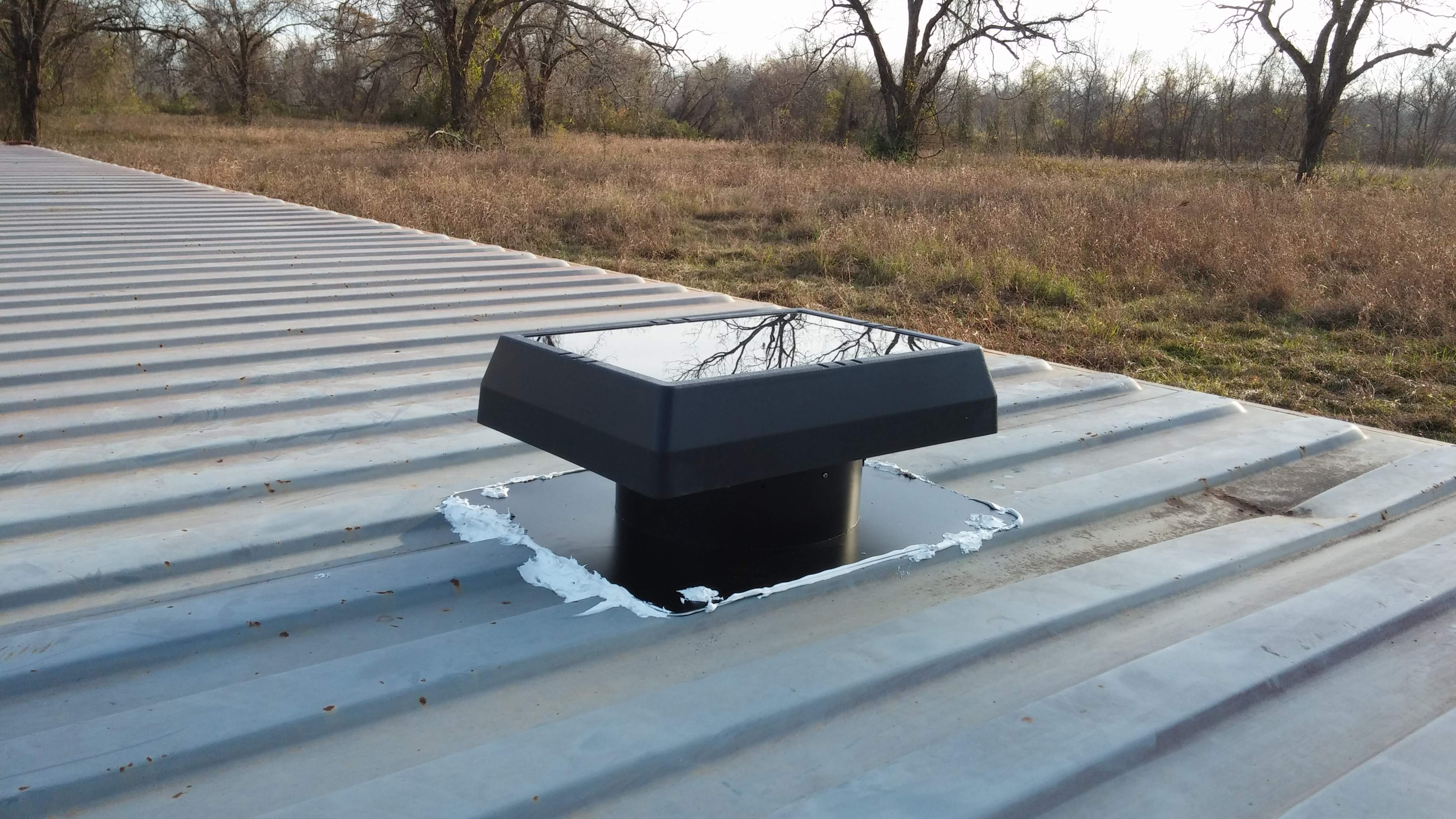

The AC part of the container is going to have 3" foam insulation. So yeah, Ken, the real question is, how will the insulated section affect the insulted living quarters. I am leaning to a 6000 btu unit.
Finished the exterior door, and also here are some pics of the solar powered vent (which has since stopped working :confused3:, they are sending a replacement).
