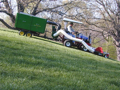

The attached photo shows the trailer with my current tractor, a Ventrac 4200 (31 hp) with 72 inch deck. I started from the 6 foot trailer from Country Manufacturing and modified it extensively. The Vac itself is made by EZ Vac (now known as Bluebird International). Trailer dumping is shown in next post.

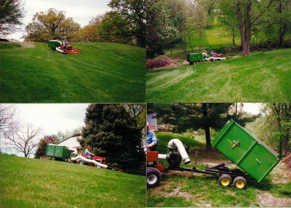

This composite photo shows the same lawn vac system in use several years ago with the Steiner tractor and 72 inch deck I had then. I added the hydraulic lift cylinder shown in the lower right to the original Country Manufacturing trailer.
The trailer holds 42 bushels. The entire top is vented and is covered with a full width and length aluminum exhaust chute that directs the flow to the rear. The vac system has internal swinging blades and a screen (miniature hammer mill) that shreds the grass and leaves. There is also a small chipper unit on the side to deal with branches and twigs. I have had the trailer in operation since 1983. This is the second vacuum unit I have had on it. I am very pleased with the operation of this system.
One note of caution for those interested in vac systems is that they really, really don't like to deal with wet grass and leaves. Mine can handle grass that is 8 inches or so tall by driving very slowly, but grass that is wet from dew or rain can often cause plugging of the hose. My boot attaches to the mower deck with a quick release connection, so it is relatively easy to remove it for clearing plugs. Plugs almost always occur in boot or within the first two feet of the hose unless the trailer is completely full and it blocks up at the connection to the trailer.

I did not purchase the Country Manufacturing Dump Option. I built my own with a 3 inch bore by 16 inch stroke cylinder. I also added the mounting flanges under the deck and on the front frame to attach the cylinder to. I moved the location of the bed pivot pin rearwards and lower in order to get a high tilt angle--it came out to be 47 degrees. The cylinder is powered by the tractor through rear outlets.
I modified the original trailer extensively, but it was a good starting point for what I needed.
