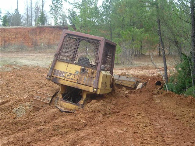

The bigger they are, the more stuck they can get!!!!
I've posted this picture before, but it's still fun to share when the topic comes up. I was trying to get more done than I had daylight and knew there was a very bad spot in front of me, but I was being careful to not go over it. As it got darker out, I lost my landmarks and went too far.
It took me an entire day with the backhoe to dig it out. When I had all the dirt around the tracks removed, I still had to tunnel under it with a shovel to free the belly pans. Once they were clear, it drove right out.

Eddie, I feel the pain! It just going that little bit too far that gets you stuck.The worst part of when the my loader was stuck was that water was within 2 inches of running into the fuel tank, it was getting dark and it was calling for rain that night. So........it had to come out.

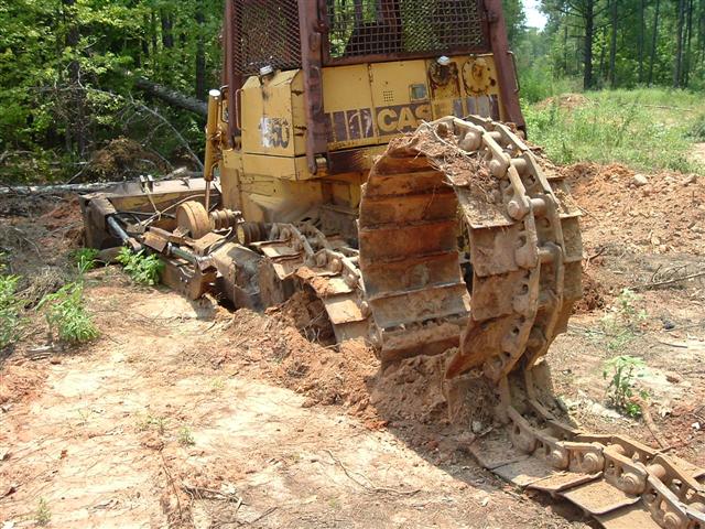

Here's a picture of my dozer when I lost a track. This is what sort of got me started on doing my own repairs. I had three diferent mechanics agree to come out and put it back on for me without a single one showing up. After about two weeks of this, I decided I had to figure it out and do it myself.
The track came off because two bolts that hold the lock together were missing. I never noticed as it wasn't something I had been checking. Then the remaining two bolts broke off. I had to take the track to a business that specializes in tracks and have them clean out the busted bolts and re-thread the holes. This took them half a day and with four new bolts, it cost me $100
I jacked up the dozer, blocked it up and then dug a nice trench under the sprocket and wheels to slide the track back under. I laid it out with my backhoe and slowly pushed it under with the backhoe. When it was all the way under, I hooked a chain onto the track and pulled it over the top.
I had already released all the tension, so it was pretty easy to line up the master link and bolt it back together.
If anybody is curious, I posted a thread on it a few years ago with more pictures.

Eddie, For the reasons you hate dozers you must love backhoes. It seems yours fixes lots of dozer problems.:D
