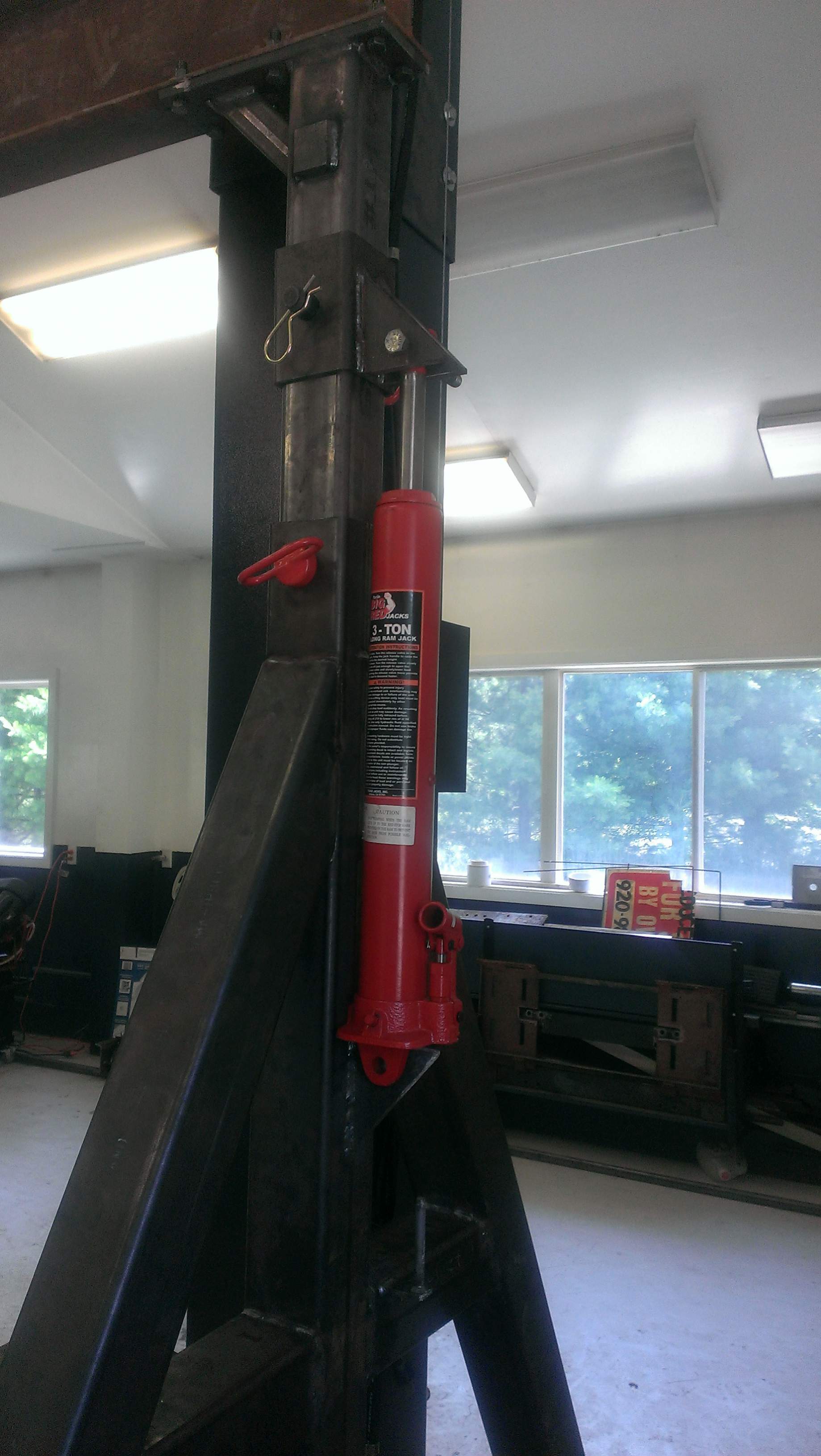

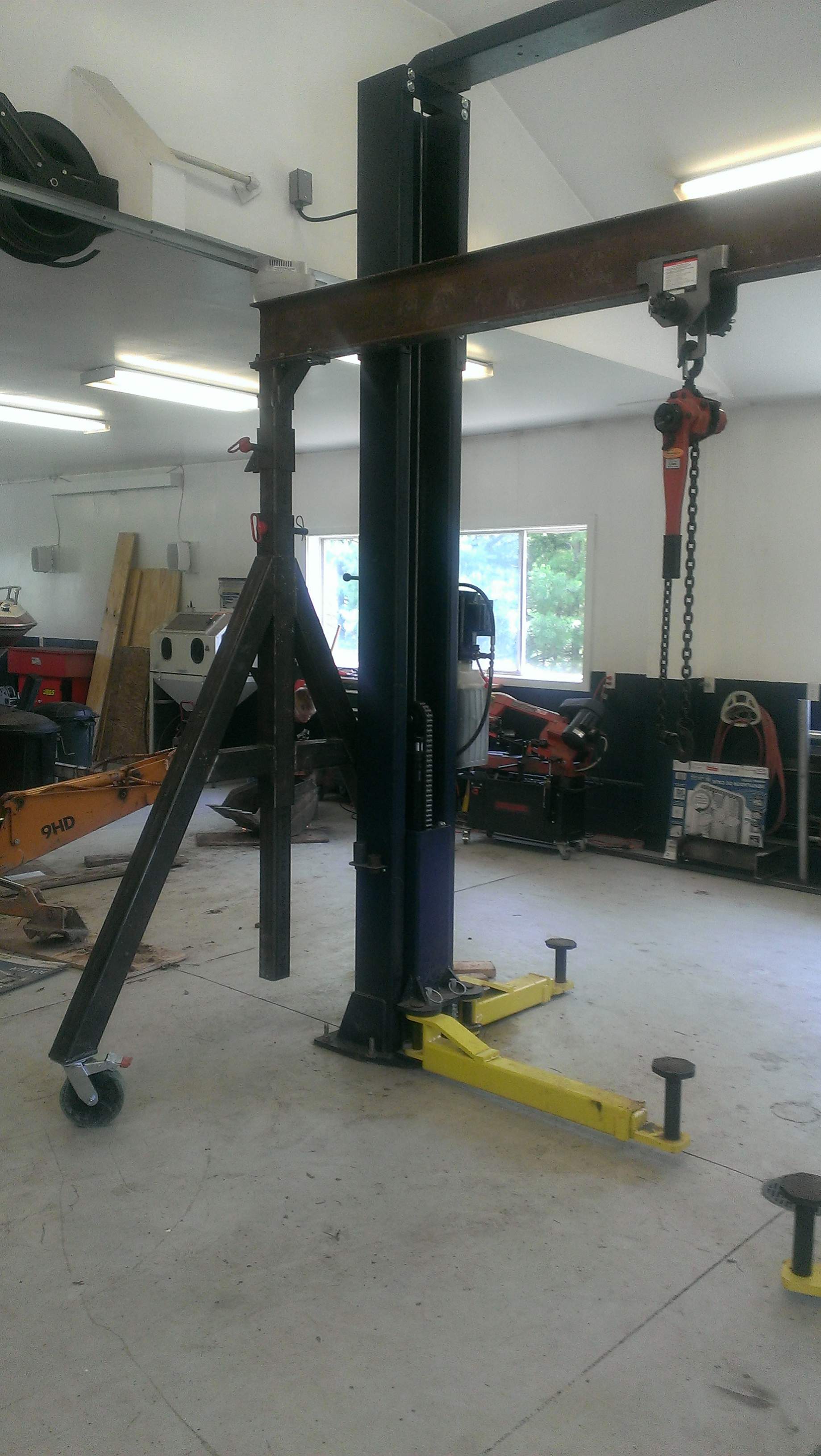

Built this A frame hoist, followed plans I found in the forum, can稚 find the post to give him credit. Works slick. Only modification I made was adding the jacks, so I can raise and lower for the different heights in the ceiling. Then I can raise it way up and tuck it in with the car lift. Steve

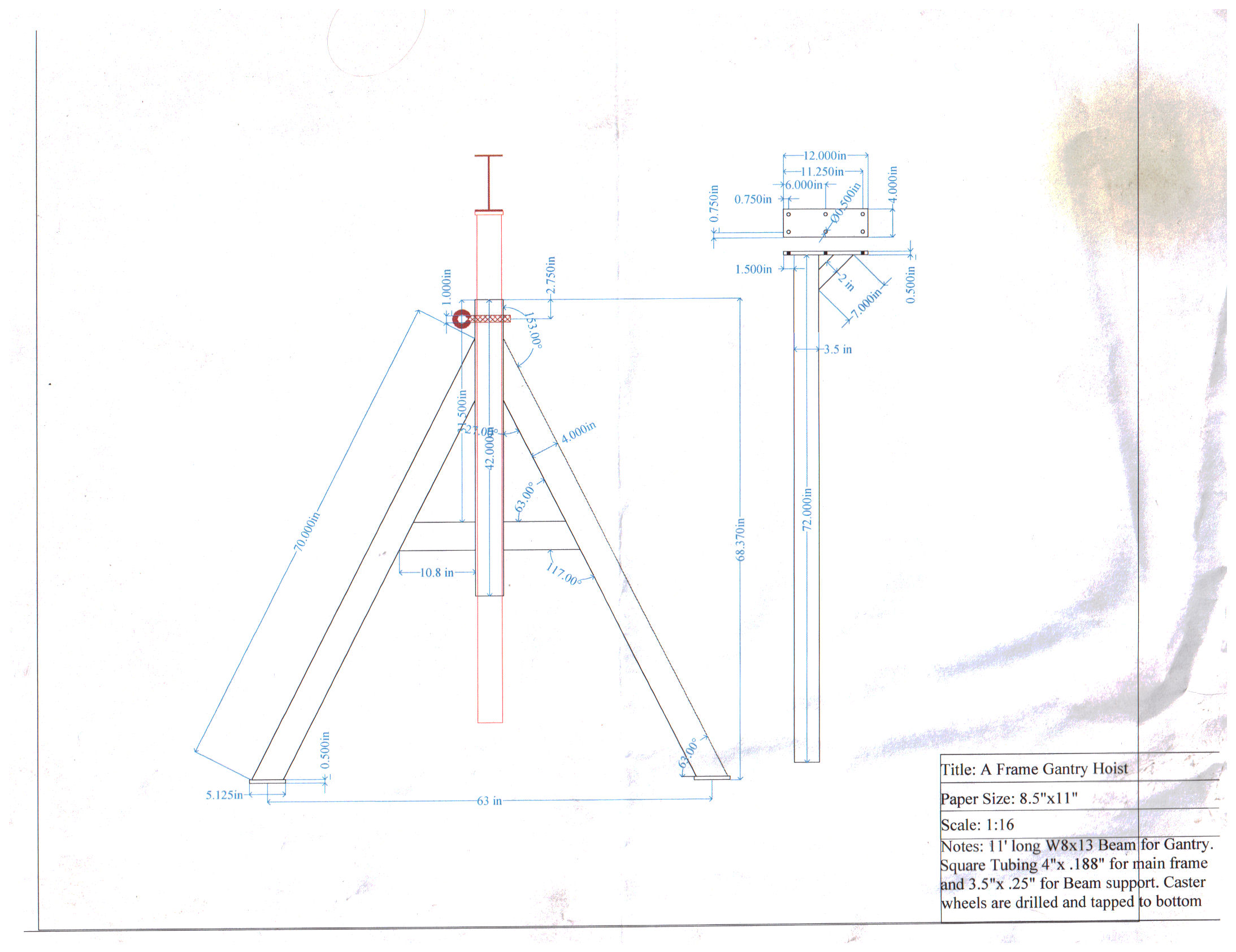

The width between posts is 11'6". We went with the odd width to clear the car trailer.
Here is a scan of the print.
We followed the print verbatim, only change was the hydraulic lift jacks. Cutting the angles for the legs was a challenge and you may want to consider having someone make those cuts.

I would add a strut at the botton, near the casters, to keep it from doing the splits.
Don't believe you need that with the size of the tube and the angle it is on there is enough material there to weld too, also went with this design just because there is no bar at the bottom. This makes it easier to roll, around the shop as you can go over the small stuff.

Just saw the two 10" long horizontal pieces in the plans. I missed them in the pics. Looks like it should hold up just fine.
You can see that if they wern't there, it wouldn't be nearly as strong.
