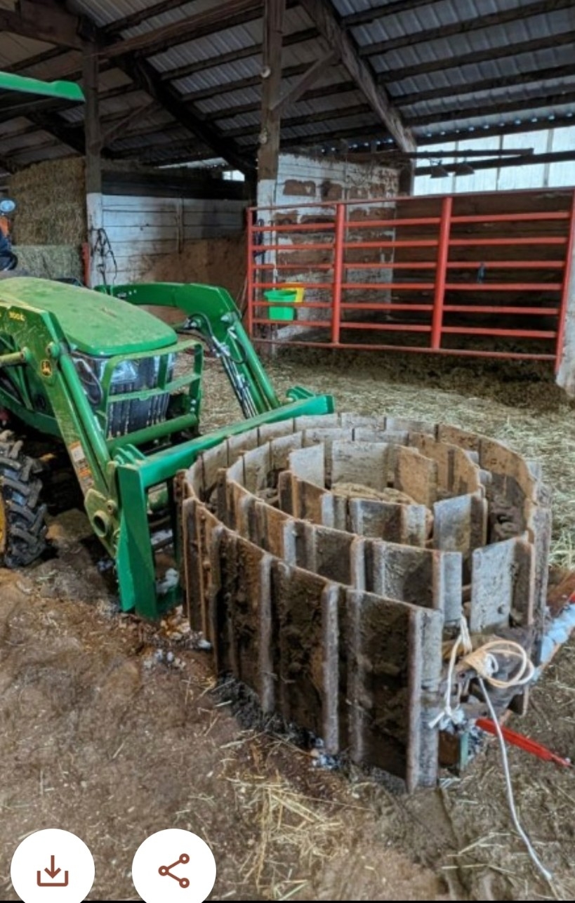

Those tracks aren't exactly light , but the little JD 3025E moved em.
