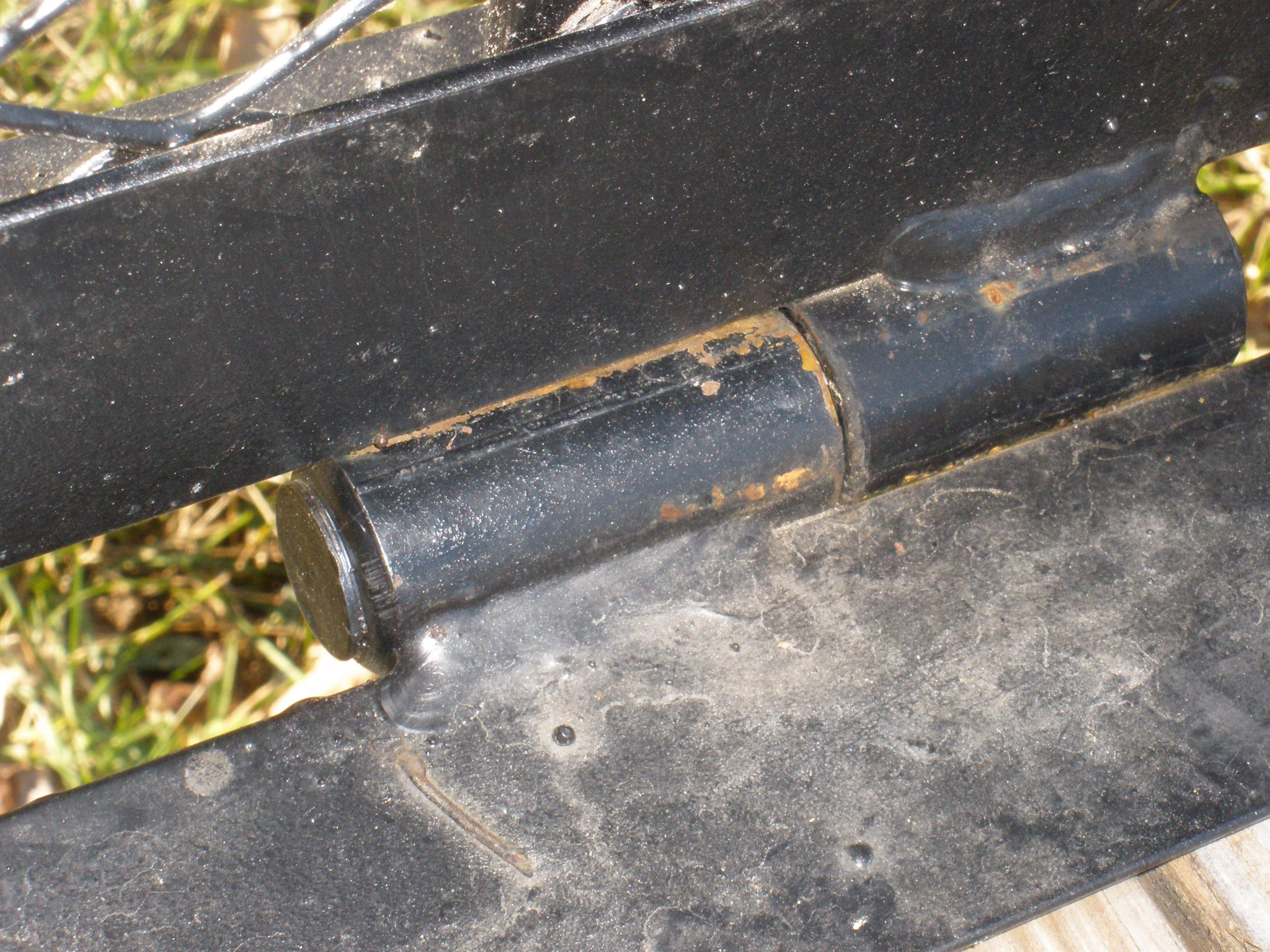

Thanks Mark,
I don't plan to go far, or use it regularly. Needed to get her to the dealer for some warranty work and couldn't afford their $195 "discounted" delivery fee, so I used what I have. Has 15" tires and 3500# axle, rated to hold up to 2950#. I do have filled tires, so I'm sure I was pushing the limit. Have to say though she towed and rode just fine (just 15 -20 miles away). The ramp/gate is super light and sagged a bit under weight so I figured I should stiffen it up anyway. All I have is a little TSC Farmhand 125 110V bimix mig outfit (hobby - still learning, it'll be good practice), the thickest I can burn is about 3/16" anyway. I'd like to get a real set up one day. Till now I've just done brackets, tabs and gussets and just finished a home made carry-all from old bed frames, so yea, the small steel came from the hardware store. I was thinking to just add a couple more verticle lenghts to each side, you think that's sufficient? Thanks for the link to BMG.

I buy from BMG regularily. Their prices are fair, and their service is good. You can buy 20 feet of angle for about the same price as 4' at Lowe's or Tractor Supply. If you order $150 or more, they deliver for free.
If you only move the tractor once in a while, I think you are fine with using what you have and reinforcing the gate. Especially if you remove the loader.

When I get my BX back from warranty repair, hopefully by Wed., I plan to weld 2 more angles on the gate/ramp under each tire track. Since the ramp is constructed of 1/8" x 1 1/2" angle and welder limitations I will use the same material. I need the practice. If still too flimsy I'll then stiffen the verticals with flat bar. I tightened my contact tip back up and cut back my nozzle to about flush with the end of the tip. Hopefully, it'll help.
On a related note... do the hinges holding the ramp on come apart? There's a zerk fitting on one end and just a flat cap on the other. Thanks again.

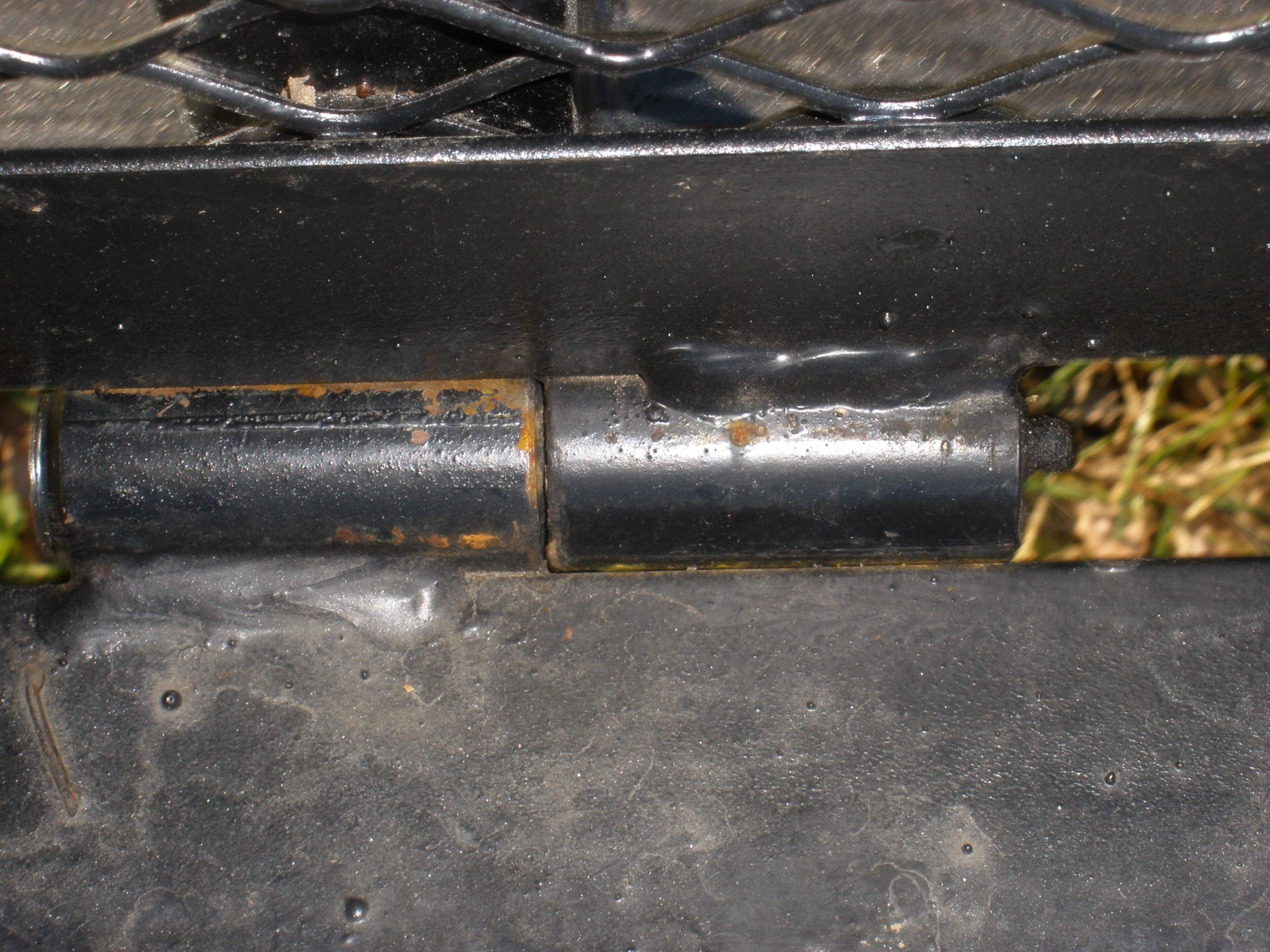

Hey Mark, do those hinges come apart??
   / a good place to get angle steel?? #99
The hinge design may change from trailer to trailer, plant to plant. Post a pic. It's either going to be welded tight or will be able to be driven out. When I build a trailer, I always make sure the gate is removable.
