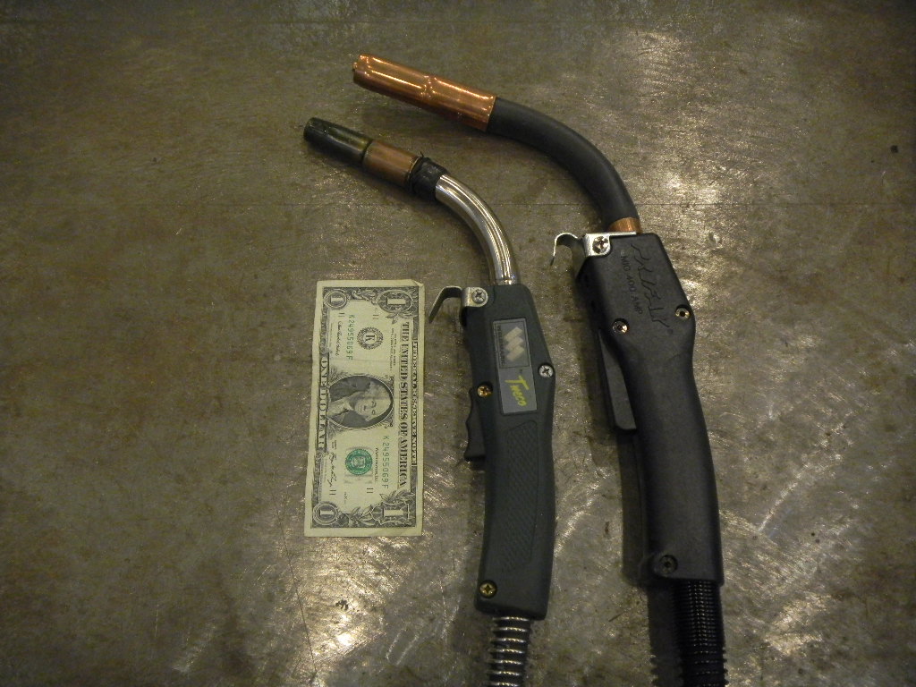

Just read some on 'stickout'. My tip is way inside my nozzle (maybe 1/4" -5/16" in) , so stickout is long. Maybe that's one reason I get big ugly beads.
I think if my tip is more even with or even protruding just a hair past the nozzle end shouldn't I get a smoother and more penetrating weld? I tried adjusting the tip to protrude more by unscrewing it some to get it where I want it, but now it's loose in the gun. Should I leave it loose or maybe trim down the end of my nozzle, or do they make a longer tip?
I know somebody will have a suggestion for me, but just welding advice will suffice. :laughing:
No tighten the contact tip up!
The amount of stickout is a very fine control of voltage. Increase the stickout and the voltage goes up, (to a point then it falls flat). Shorten the stickout and the voltage goes down. High voltage / long stickout is a hotter wetter puddle. Low voltage / short stickout is a cold dry puddle. I've had gas nozzles that I had to sand them down. Generally I like them where the contact tip is even with the end of the gas nozzle, but I also like adjustment where I can have the contact tip out beyond the gas nozzle a little bit.
With most Mig wires, and flux core self shielded, (T-11) wires, I like to run about 3/8-inch stickout. With T-8 wires you have to run as much as 3/4 to 1-inch stickout.
Thanks Shield Arc, AGAIN! You're quickly becoming my welding guru!
