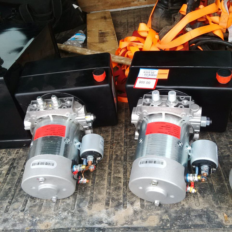

I know my MF135 Power steering pump was about 800 PSI. I saw these at Princess Auto for $69 so I bought two. One has dump trailer in its future.
