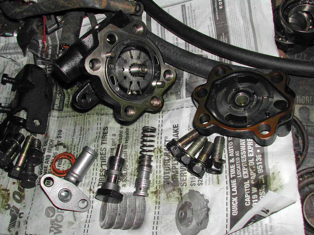

Most recent automotive PS pumps, as well as other accessories, use multi-rib belts
instead of V-belts. This has been true since about 1990, and adapting my new pump
to the old Samurai required a dual-belt crank pulley. I decided it was a bit easier
to make a hybrid pulley, versus changing my pump over from multi-rib to V-belt.
So, I cut and welded a mult-rib pulley to the V-belt crank pully. I used a lathe to
make sure they welded up accurately (photo #1).
Making the bracket for this small pump was the toughest part of the whole project.
Photos #2 and #3 are the mounted result.
