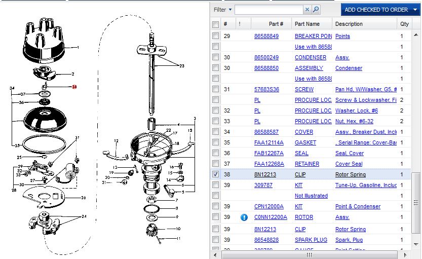

if you didn't get the 6$ oem clip.. that oem rotor likely won't fit any better than a tisco one. unless you leave the masking tape on.. then it will likely work fine. :)

Soundguy, the rotor I bought doesn't seem to have any place/spot that I can see or saw on the IPL at the dealership where a clip would go...? Maybe you can tell what/where I am overlooking. This rotor is just black plastic push on type from what it looks like...
   / A little bit more technical advice please #65
The clip is basically a steel spacer that slides over the top of the distributor shaft to take up the slop, they all need this clip it is just the way they are built.

Thanks Guesseral, that's makes sense... I will have to see if I can the find that clip/space on an IPL.

Thanks kf4uda, I was able to view the second link of the part, but not the NH IPL link for some reason. I have tried that part look up before and had no luck either. I get the point from the pic on that second link, and I know for sure I do not have that clip on the distributor drive shaft. Appreciate the links and help, thanks.
   / A little bit more technical advice please #69
Not sure why the link is not working for you but here is a screenshot of it.
#70
Thanks Chris, that's the ticket. Looking at that diagram.... I need to go out and check, but I think I am missing a couple other things too. The gasket for sure. I appreciate the diagram.
