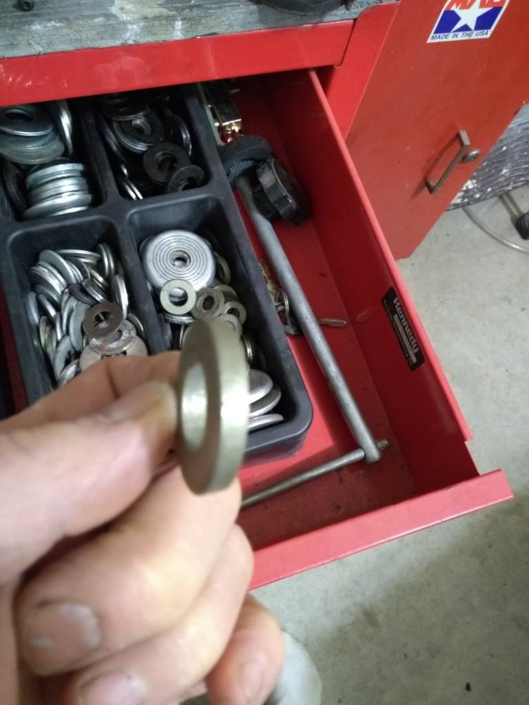

My rears are 192 lbs. (L39). With a hardened heavy washer. Fronts are 100 with taper nuts. That kinda torque should keep them from moving. Buy heavy washers from Fastenal and try again. IMG_20190220_163637940.jpeg
