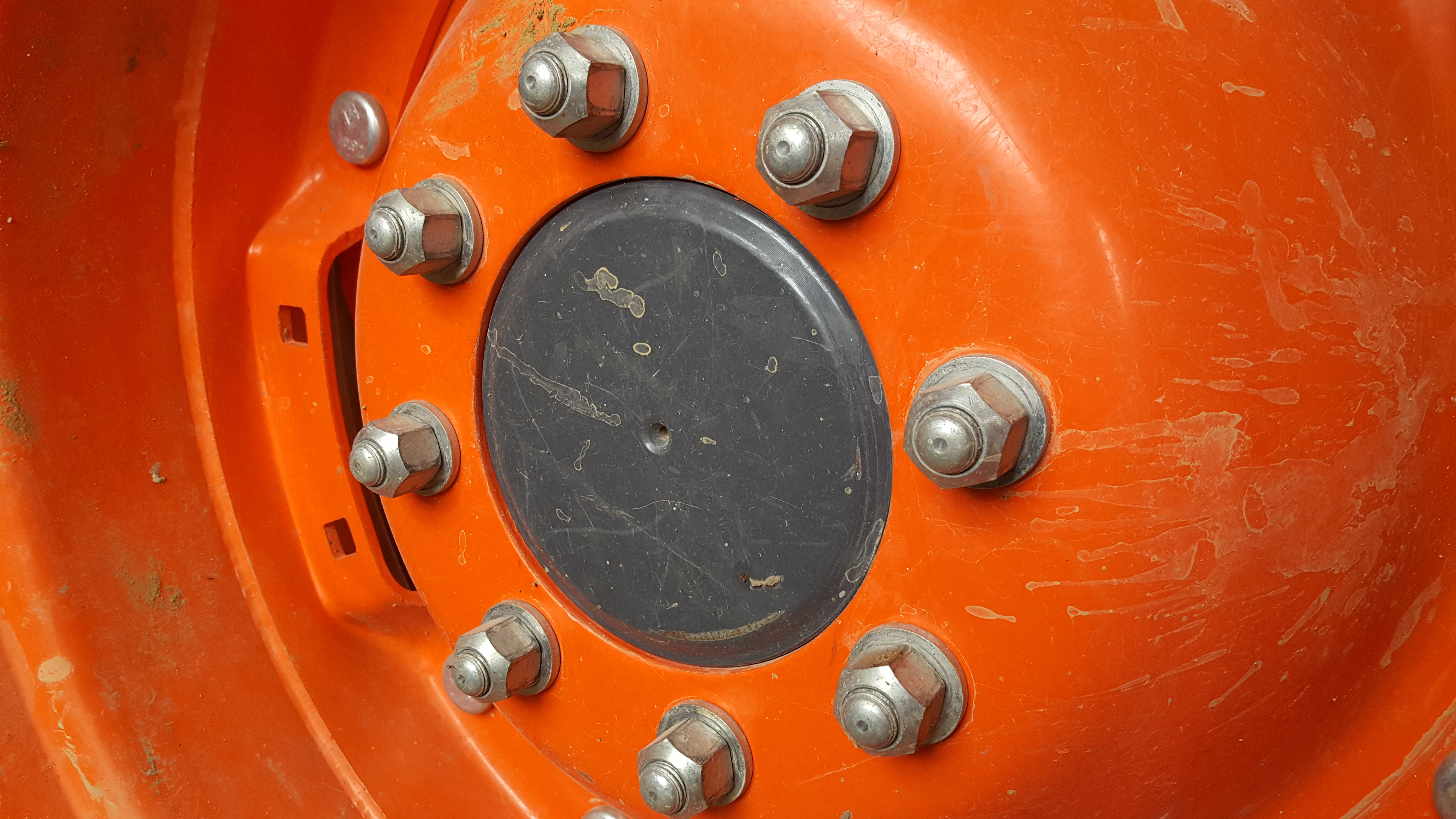

Here's another pic of a hub centric setup. In this case the nuts are multi-purpose. One side is tapered. In this application that wasn't needed so they were applied with flat face toward the wheel.

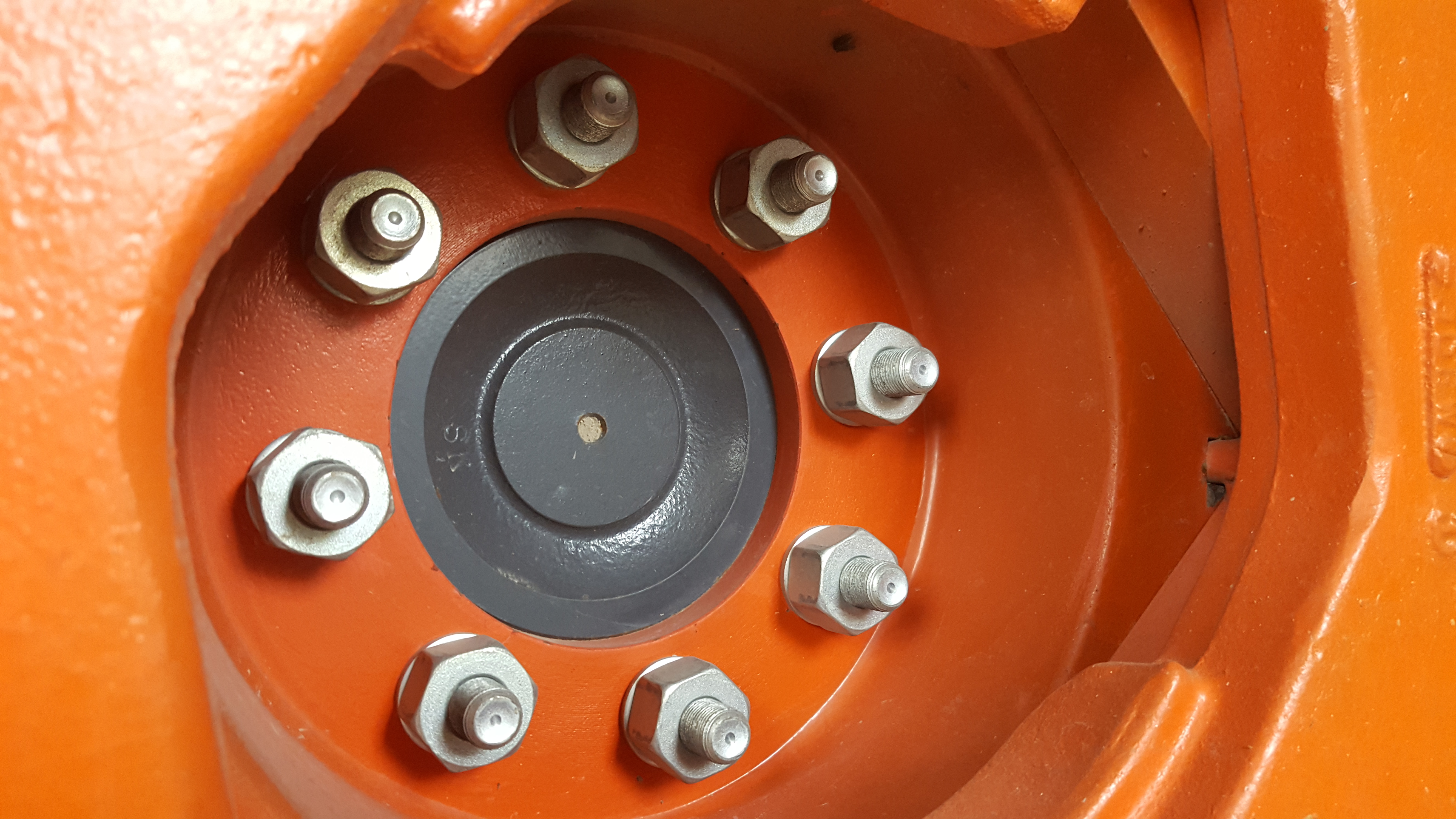

Here's a pic of a rear wheel. It's hub centric. The bolts/nuts prevent spinning and hold the wheel tightly on the hub. They do not keep the wheel centered. The nuts are flat on the backside and use a flat washer.
Yep, that's what I am familiar with. Though I thought 2 of the studs were bolts going inward.
   / A little disappointed with Kubota #44
They are on smaller models. These pics are on my M9540.

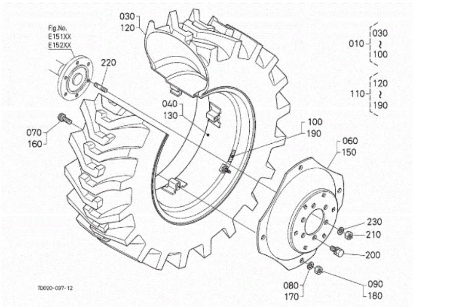

The exploded view on Kubota's parts diagram only shows the nut (item #210) and the lock washer (item #230). The bolts (item #2000) have captive lock washers on them. If you add an extra washer (my plan) then the bolts are too short as when they are tight the end of the bolt is flush with the inside of the axle. Since any length bolt is available I would expect Kubota to use a longer bolt if a washer was suppose to be used.
If you look at your first picture vs your second the nuts used in the first picture are oversized. That's why you can't see much of the washer underneath. The second picture looks more like mine except for the fact that yours has washers.

The nuts are oversized because the torque spec is a lot higher than yours. Hard to tell with pics. Mine are a lot bigger.
The part about this that disappoints me is that your setup isn't hub centric. Even my little JD2210 is hub centric.

Here's a picture of the bolt. It's a M16 that a 24mm socket fits on. By my estimate that makes the outside of the lock washer about 28mm. That's not a lot of surface area to hold the wheel from sliding. The belliville washers I've got are 5/8" inside, 1 1/2" outside and are 3/16 thick.
