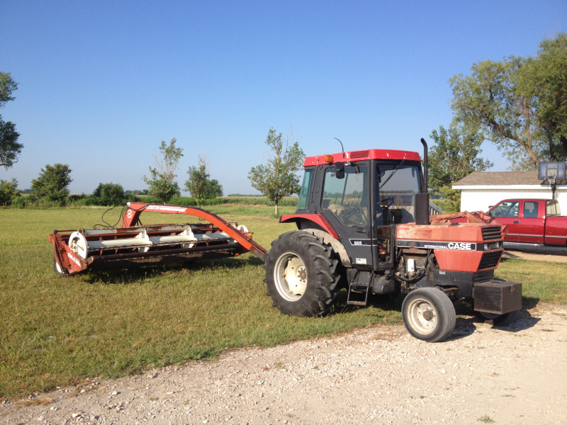

The swing cylinder is DA the raise is single acting on the windrower. I think Aaron Z might be on the right track that the QA couple on the tractor may be the culprit. I will have to check them out tonight. That would explain why it would go the other way when I would switch the hoses.

I read them by following the hoses but for the factory setup there are colored stickers on each side that match the color of knob on the handle in the cab. It is a little different how they hook up so far apart, but that bottom set is the only ones that work correctly.
Last night I just Fixed the handle for the factory valve to get me going. I had to fix my windrower also. Now i get to haul my 14' wide windrower 20 miles to the field across town (should be fun) and get going. Hope nuthin breaks for once.
