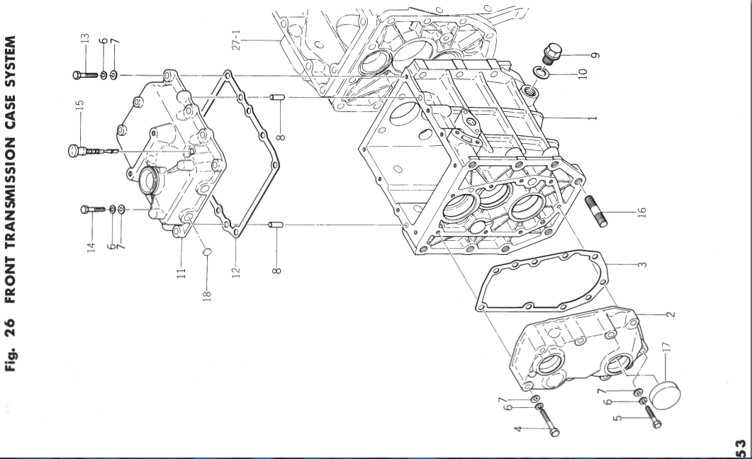

Thanks for your replys Mitch,
I seen and contacted the guy selling the trans on Ebay, he stated the only G174 parts he has is what's listed on Ebay. :(
The parts I need are the transmission input shaft and the spline boss that connects the output shaft coming from the flywheel to the transmission input shaft. Free time and the cold are keeping me from getting under it and looking to see what broke so not sure if the "pin" sheered or some other meaningful carnage was done.
The tractor had a manual with part numbers but my neighbor seems to have lost it, but I believe I could pick the parts out if I seen an exploded view of the trans.

I removed the front drive shaft and had a look under the tractor today, neighbors makeshift pin did sheer and no other damage was done, splines on the transmission input shaft are toast for sure, I would think the same about the spline boss. I made a new pin out of stainless and put it in the spring clip hole and the tractor can move under it's own power again, the hole is so small and the pin my neighbor made was made too small it makes me wonder how he used it to mow his fields for an entire summer.
I ran the tractor up and down our driveway and noticed a sound in the transmission that makes me think there is a damaged tooth on the high speed gear, makes the same sound in low or high range but only while in 3rd or 6th, something more for me to investigate when I do break it apart.

Thats too bad about the splines and the pin. I attached the exploded diagrams and hopefully we can help you get the tractor repaired, and hopefully it will be relatively inexpensive! I have weights on the front of my G154, and I had to measure very carefully to get the most weight out of the small front bumper that the tractor has. I was able to attach (4) 42 pound suitcase weights, and they are an exact fit. I bought them at Tractor Supply and they are made by MTD. My front tires are loaded with washer fluid, and it helps add extra weight. They have been loaded for the entire life of the tractor without any issues.

Here are the diagrams, and a photo of mine with the weights and the ROPS. Let me know if you can identify the damaged parts. I have a list of all of the parts numbers, and we can start there with a search..

It looks like the part that is labeled number 1 is what I need, it's hard to tell as the lines for placement on the diagram are a little faded, if it's darker on your end it's the top most shaft that exits the front of the transmission, the lower shaft is for the front wheel drive. I would also need the collar that connects both the output shaft from the engine to the input shaft to the transmission, my neighbor said his repair manual called it a spline boss but can't remember any other info.
