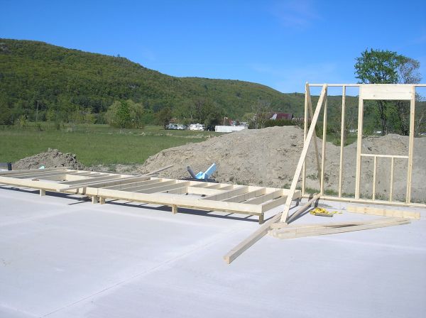

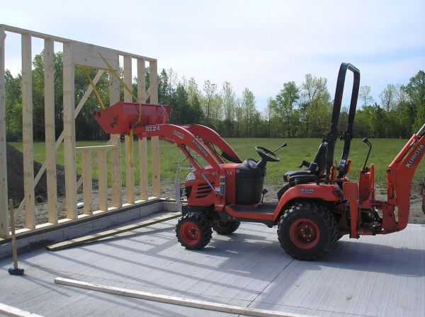

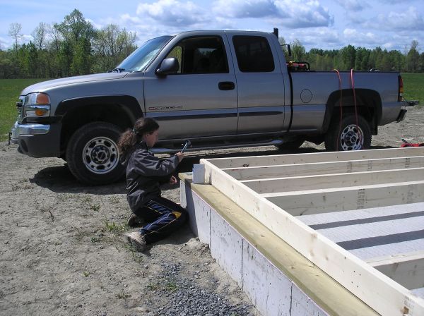

Well, its been somewhat snowy winter and a wet spring, but the stables construction has been restarted.
This spring I did the following to get prepared for the framing:
-dug a 4+ foot hole on each side of the foundation wall in order to bore a couple of 4.5" holes that we forgot last autum. Bx24 came in handy there. Also installed the plumbing for well-water input and waste-water output.
- skimmed of about 2+ inches of gravel fill in order to increase the concrete floor thickness.
- added some poly and and 1" styrofoam sub-slab insulation.
- poured the slab!
Now that the prep work has been done, the fun of framing begins. I've got the mud sills installed and have started nailing and raising 12-foot long wall sections. The bx24 come in handy for raising the walls as shown in the photos - using the tractor makes it a one-man show... except for the rare times the kids want to get involved.

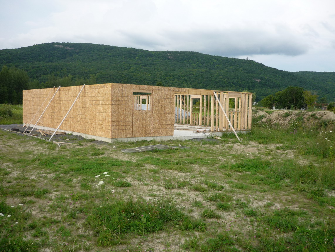

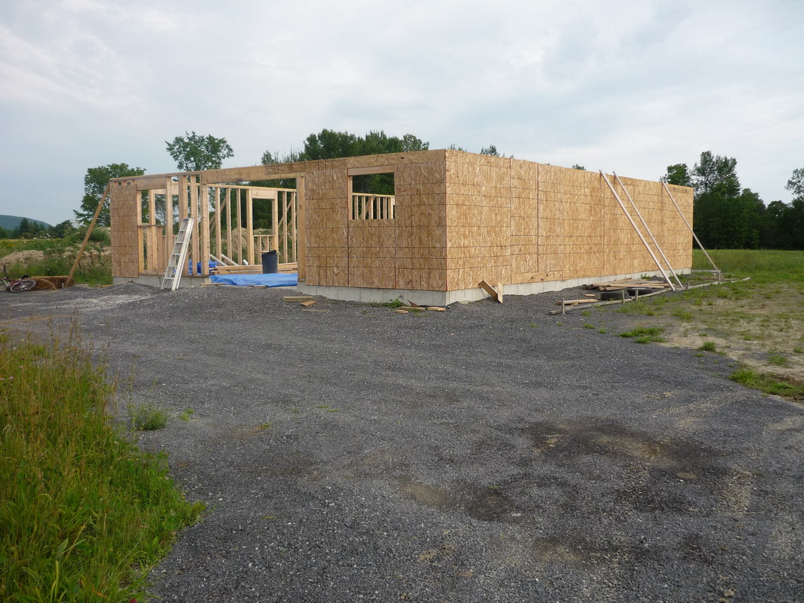

Here's a quick update - got the walls up and finishing up the sheathing. The roof trusses will be delivered next week...

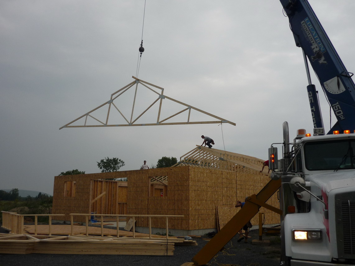

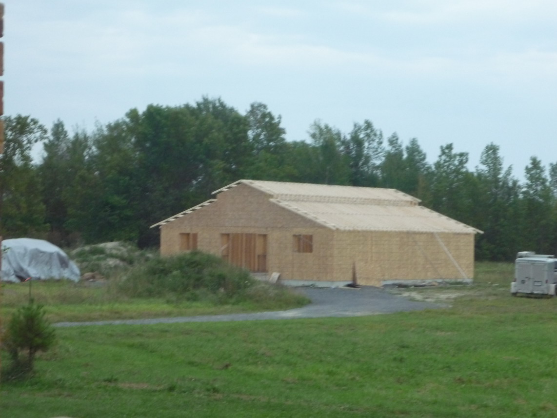

#17
Thanks Eddie...
Finally got the roof trusses delivered and installed. Got some OSB on the roof too. I didn't do this work myself - hired a pro crew to do this. Those guys really know what they are doing. Here in Quebec, framers go thru a 2000 hour apprenticeship and a tough exam.
Anyways, got the metal roofing order and I should start installing that this week.
Here's some pics of the framers in action...

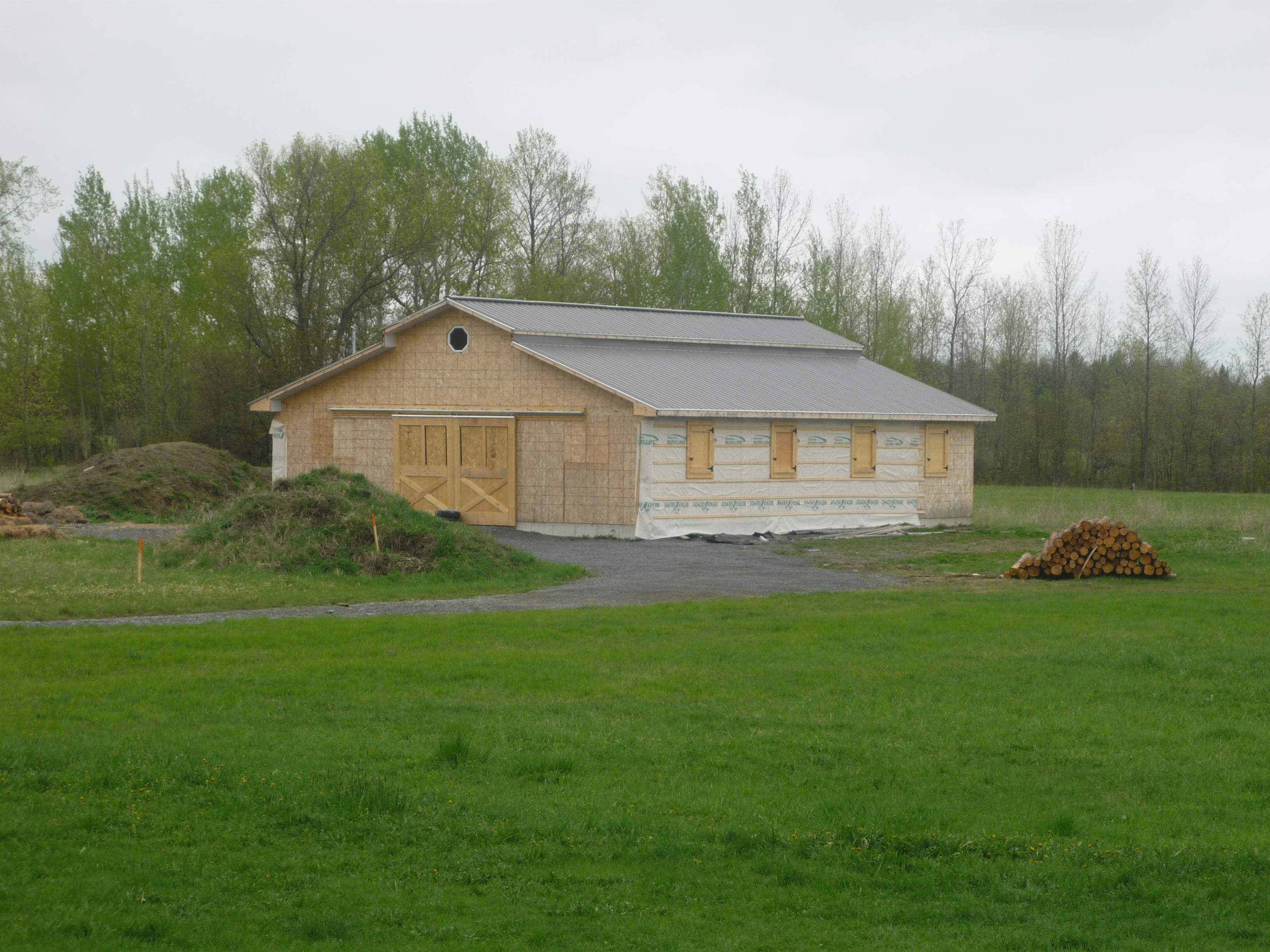

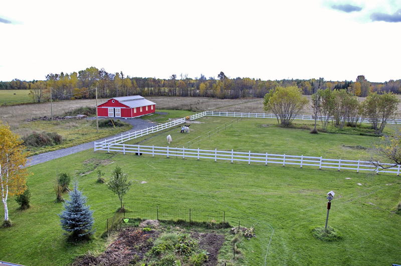

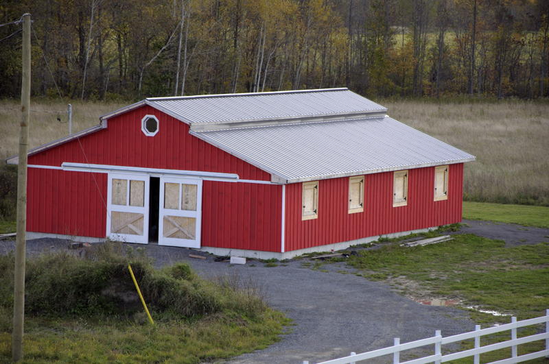

Its been a while and it seems I haven't done much in the past year. What I did this summer:
-finished soffits before too many pigeons moved in.
-installed metal roof.
-built and installed hanging doors front and back.
-cut out, built and installed stall windows
-applied housewrap and straping to exterior walls
-applied pine board&batten to exterior
-painted (C3-brand solid latex stain) red siding - got to cold to do the back wall
-started on white trim
-tamed some pasture, cleaned out junk, and filled in low spots for horse paddock
-built 3-board cedar-post fence
-painted fence white - kids helped for 2 hours then got bored.
-got electrical panel in and got power
-started on tack room walls
In progress:
-redigging 1200'+ ditch in main (wet) pasture
-insulating half of barn (hay in other half)
-laying out and install of 6x6 cedar posts of 4 stalls
What I didn't get done (my planning was too aggressive):
- 300-foot water line from house
- hay storage shed
- pasture fencing
- horse stalls
I added some pictures taken from the roof of the house...
Also, I'm gonna need a bigger tractor...

Looks very nice. I'm curious why you put trusses in a monitor style barn. Doesn't that kind of defeat the purpose of the raised center aisle (loft)? Was it that much cheaper to build with trusses?
