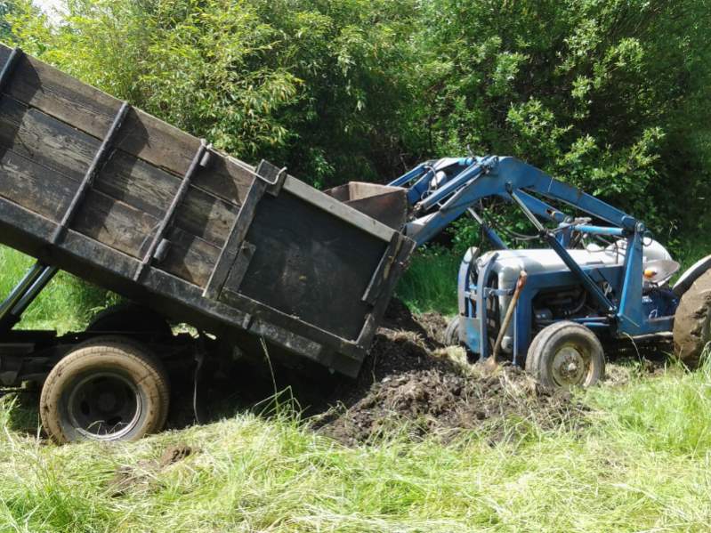

She is getting there. Ran good. Today. Managed to find the only wet spot on my property probably from a leaking underground irrigation line and stuck both my dump truck loaded with manure and the NAA while trying to unload the truck. One of those days. Decided that the next project will be to ballast the tractor.

manure truck stuck eh? 'stuff' happens. ;)

Yeah this was literally a streaming pile ;)

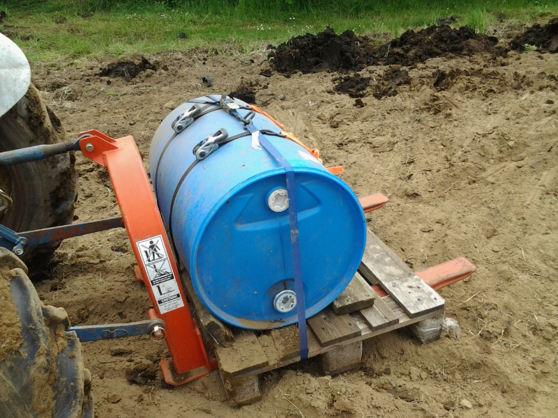

Made up a quick ballast set up comprised of my 3pt forks, a pallet, and a filled plastic 55 gallon closed barrel. (Tried loading a pict but the app keeps crashing). It worked well and i was finally able to back off with a full loader bucket. Got two truck loads of manure moved.
Tomorrow i hope to run the tiller through it but i'm unsure if i need an over running clutch adaptor. The tiller has a slip clutch and the shafts mate. I do need to shorten it to avoid bottoming out the shaft.

"Tomorrow i hope to run the tiller through it but i'm unsure if i need an over running clutch adapter. The tiller has a slip clutch and the shafts mate"
You only need an ORC for a rotary cutter.
The ORC acts as a ratchet to stop the inertia of the heavy, spinning cutter blades from pushing the tractor forward when you depress the clutch pedal.
ORC RELEASED
ORC ENGAGED
Think of the black outer ring in the graphic as the mowers PTO shaft and the grey inner section as the PTO shaft on the tractor.
The slip clutch acts as the weak link in the PTO equipment drive line. It will "slip" and keep the tractor from shredding the implements gear box if you hit an immovable object such as an underground stump.

Thanks DB. I thought that might be the case. Just wanted to verify. Great diagram.
