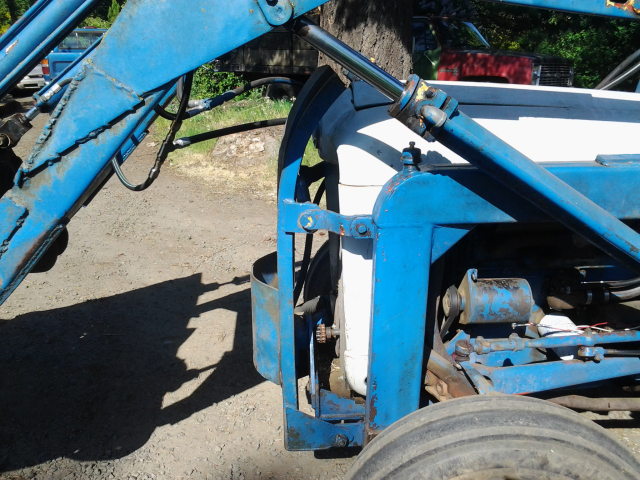

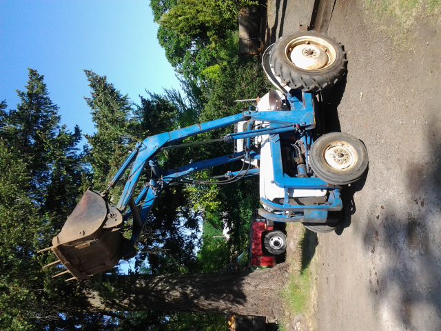

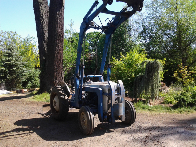

As promised some pictures....don't worry i only raised the loader to full height for the photo op.
Not to pretty but getting to be more reliable.

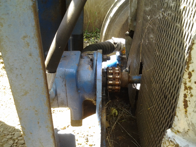

Nice install on the aux hyd pump.... Is the flex hose the supply hyd fluid from a resevoir ..

That hose is the supply from the tank to the pump. The tank is the frame. Can't claim much design credit just a bit of clean up. Thanks for the link.
