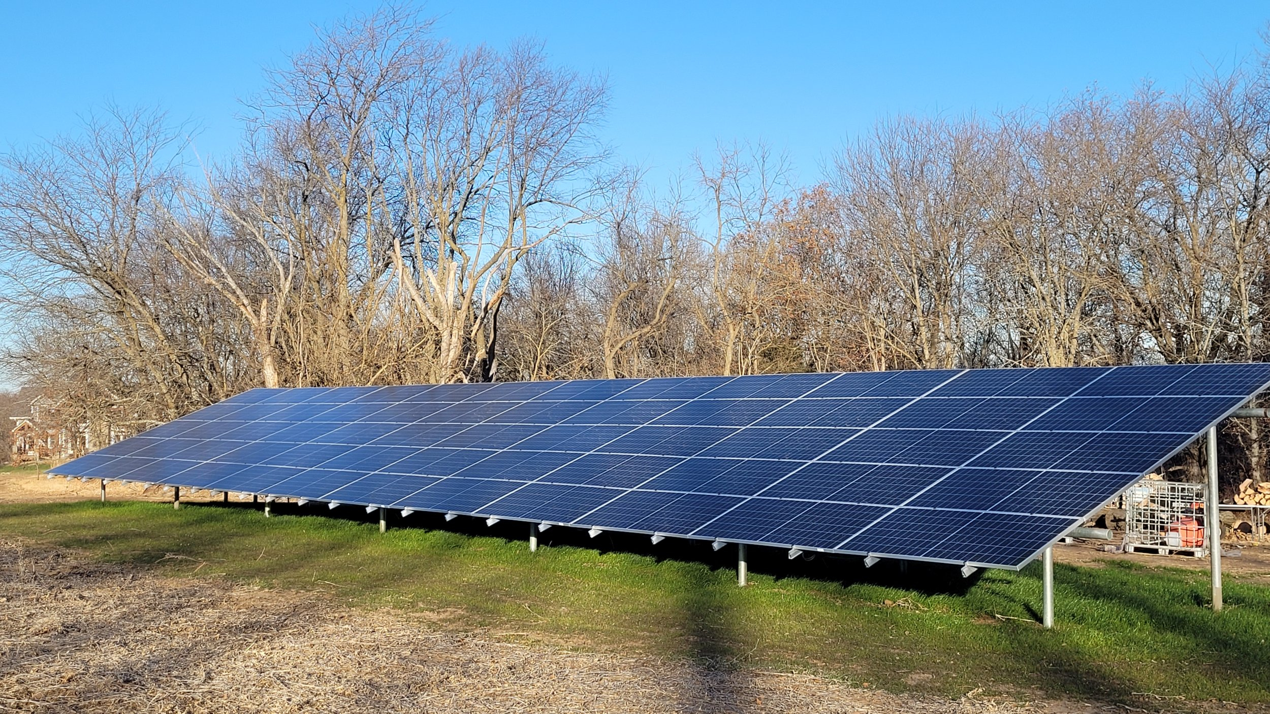

Panels are getting a test tonight. So far so good but we are getting wind gusts in the 80+ mph range. A few strong enough just now when I was outside checking panels that they were pushing me sideways and hard to stay on my feet. Looks like I may have a small amount of shingle damage on the roof. Will have to check in the morning. Big props to our electric coop. They do a great job of line maintenance. Most of our nearby city is out of power and ours hasn't even flickered.

This was a nice site to see this morning. I know of 2 people that lost panels last night. Lot's of downed fences, trees, etc. Highest wind gusts recorded in our area were 85 mph. We never lost power but the outage map showed 27,000 without last night.

Great job on the construction!
All the best,
Peter
