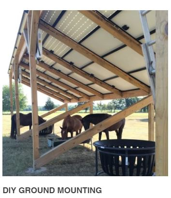

I had thoughts of having my ground mount be up higher so that horses could use it as a sun shade in the summer, but the standard mount needs to be installed near the ground and raising it would completely change the engineering calculations for wind.
There obviously exist these things (local businesses have large carports of solar) but considering the prices I'd definitely get something engineered even if you DIY the work.
Sort of like this?
or this?
That's sort of what I was thinking about.

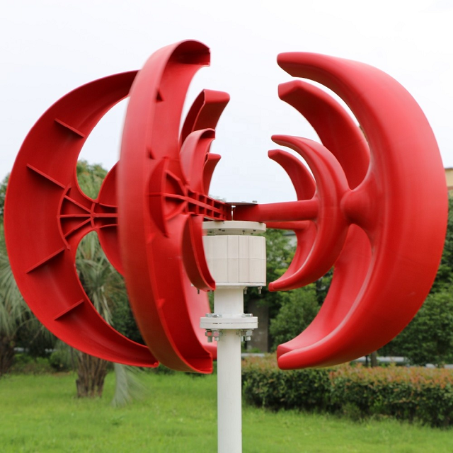

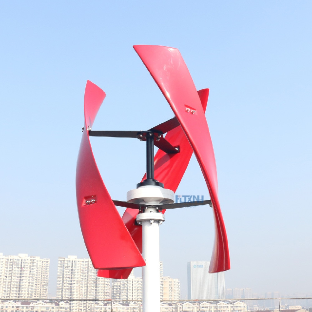

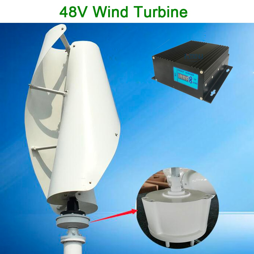

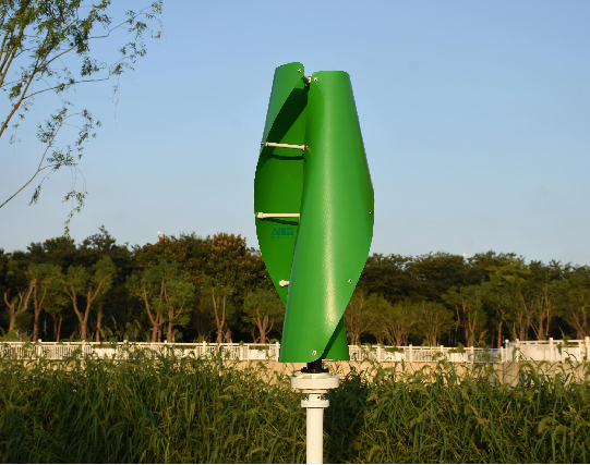

With my farm, solar here is 12VDC & 24VDC for all sorts of things. It's more auxiliary and/or supplemental for our uses. And in a power outage it carries us thru for a few days straight. It can't keep up long term with daily activities, but it can keep the necessities viable; several basic barn lights, fence energizers, water heaters, and charging Li cordless batteries for tools and other devices. The key here is what smart charge controller is in place. Very few can charge lithium batteries at all.
Sun during the day and in the winter months, we get wind at night. Thus, the wind style generators here in the mid-west at times generator MORE power than solar.
For wind power generation for home or farm, the vertical generators work the best, take up way less space, closer to the ground to maintain, and are not an eye sore either.
I've made my own looking much like this - - -
Depending on the DC motor/generator, one can get constant 400W of power in a steady breeze.
Mounting on 4x4 wooden farm fence posts is very easy.
I made mine with simple plastic gutters one can buy from Home Depot to shape the plastic blades.
The bearings are SKF or FAG from the MTD catalog at my local hardware store.
The motor is 24VDC 550W. The key point to know is the rotation of the motor to then properly shape the blades to the wind. This gives the most power. Doing the rotation backwards gives less power.
And ensure a blocking diode (schottky diode) is in the loop too for EACH unit ! Can't have them ganged together without them !!!!!
Now, if you are not talented and make something like this, then prepare to experience lots of loud wind NOISE. People make these from cutting half-moons out of 5-gallon buckets. ;)
Now, when those hurricane like winds come, the low height wind generators can have the bladed un-locked from their perch and simply removed. This way, no damage to deal with. We had that spat a week ago. 75mph to 110mph winds were clocked.
