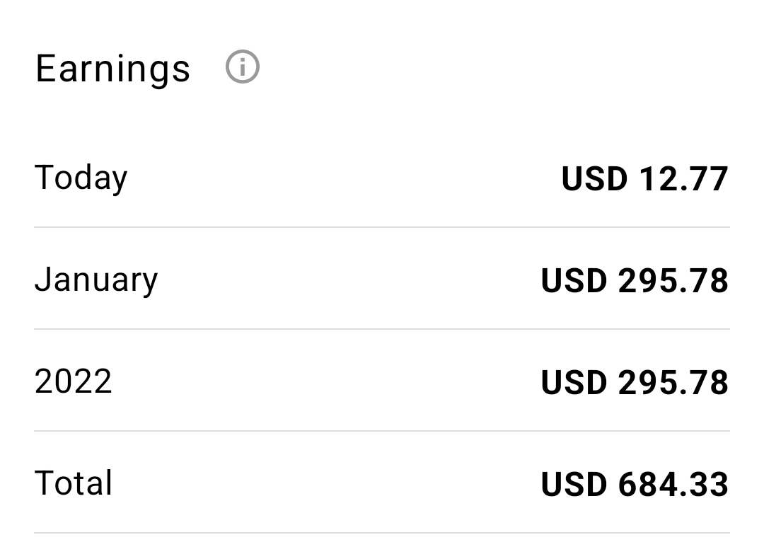

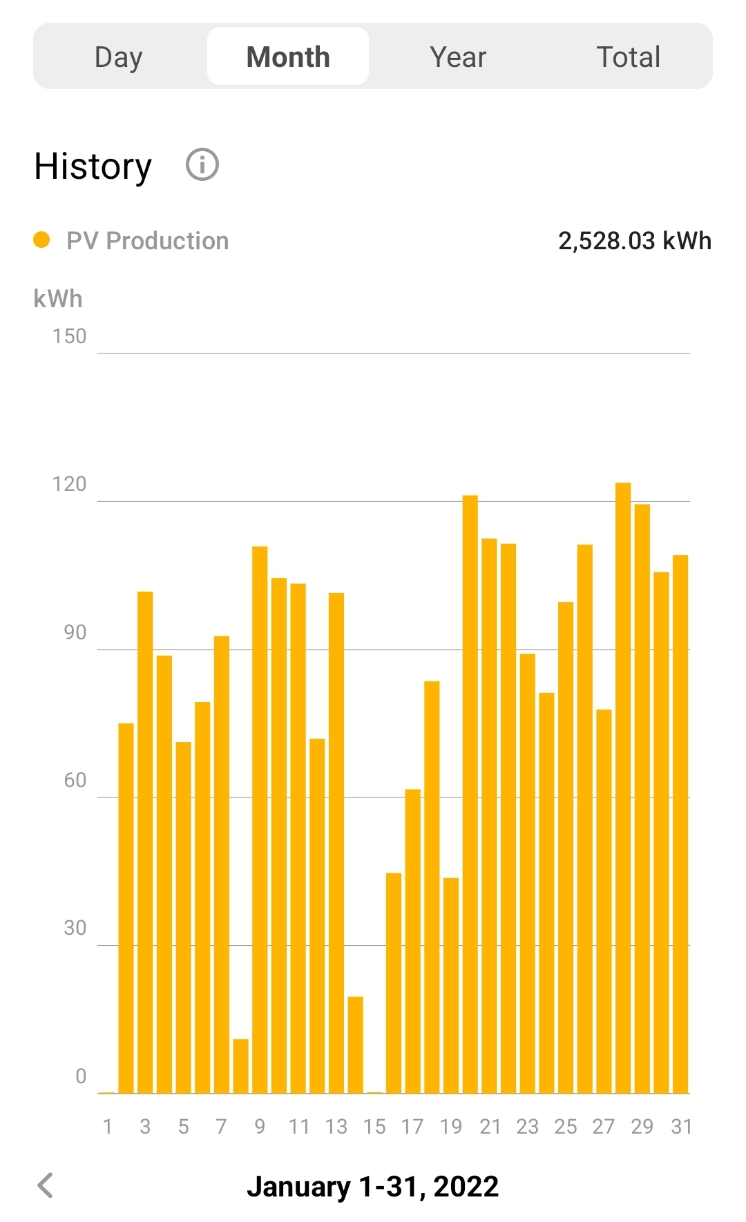

Jan update......Probably won't post another until end of the year as a recap but so far so good. My Jan estimate was 2510. Actual production was 2,528 kWh reducing my bill by $295 for the month at our 11.7 cent/kWh rate.

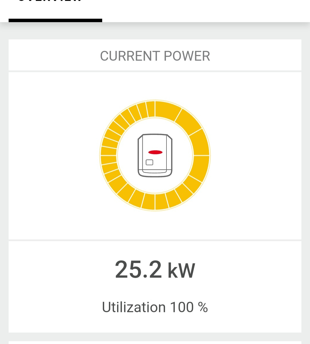

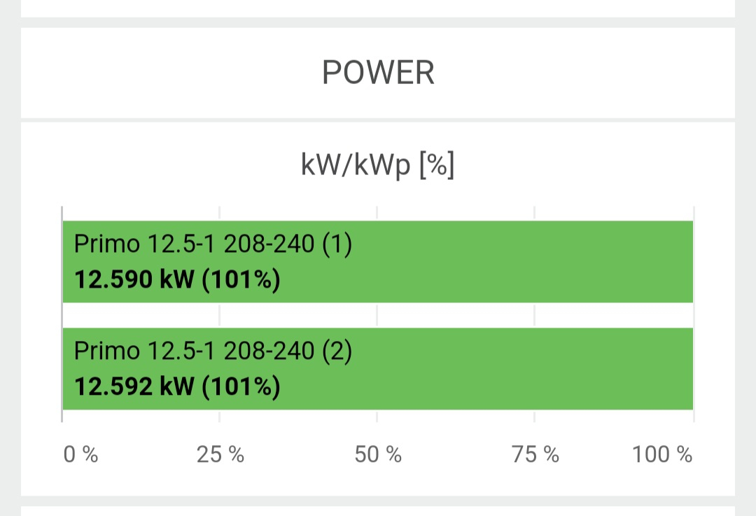

Panels were really producing today. The combination of full sun and cool temps to keep the panels and inverters cool had them just above max rating. My inverters were showing 25.2 kW at peak sun today. Total panel rating is 24.9. (60 panels x 410 watts). Putting about 135 kWh to the grid per day now on a cloudless day.
   / A newbies DIY solar install #219
Congratulations! That's great, and quite early in the year.
