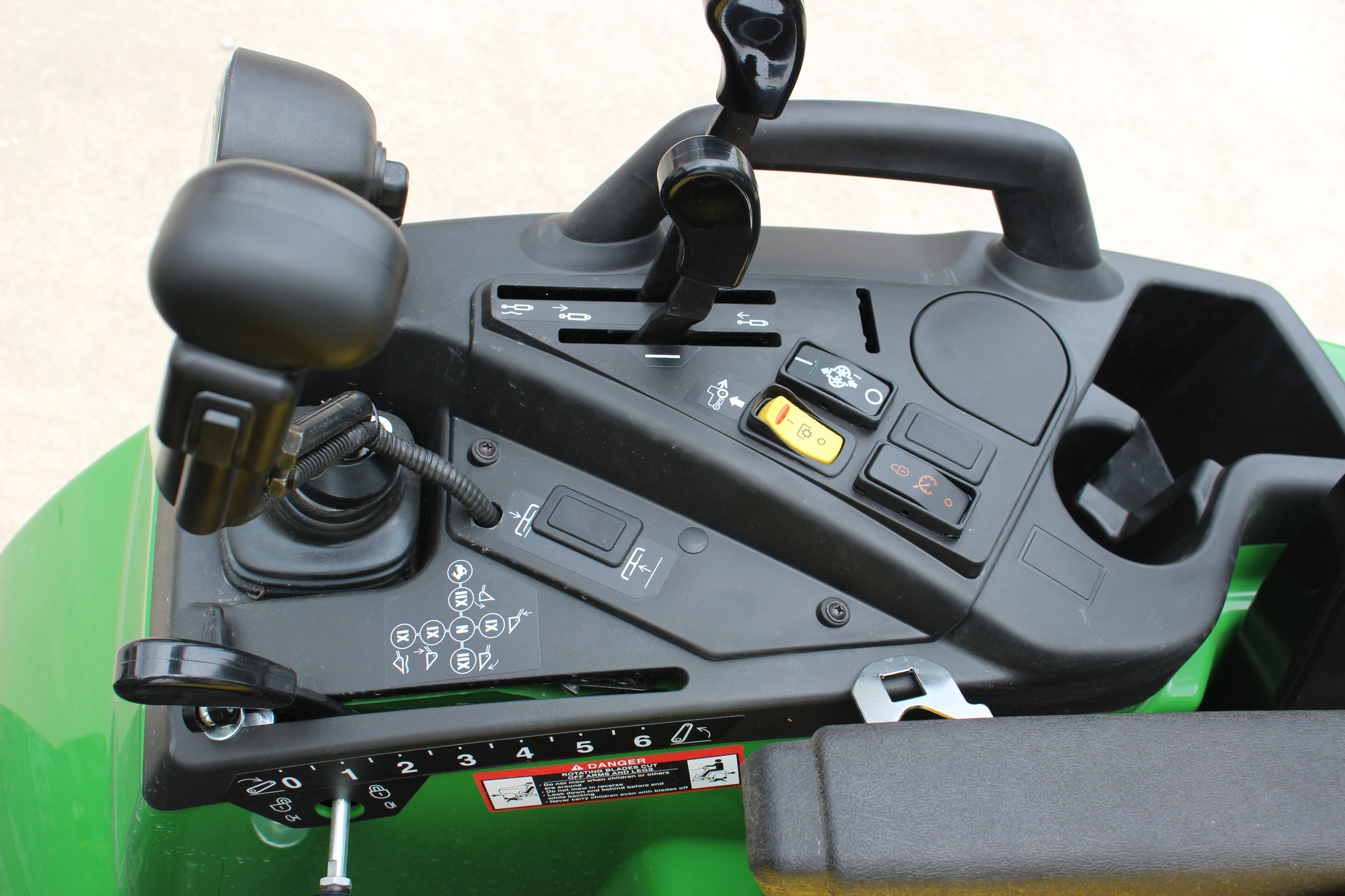

What is the switch on the loader control lever??
It is for the 3rd loader function. It is an extra set of hydraulic outlets on the front for things like a grapple.
