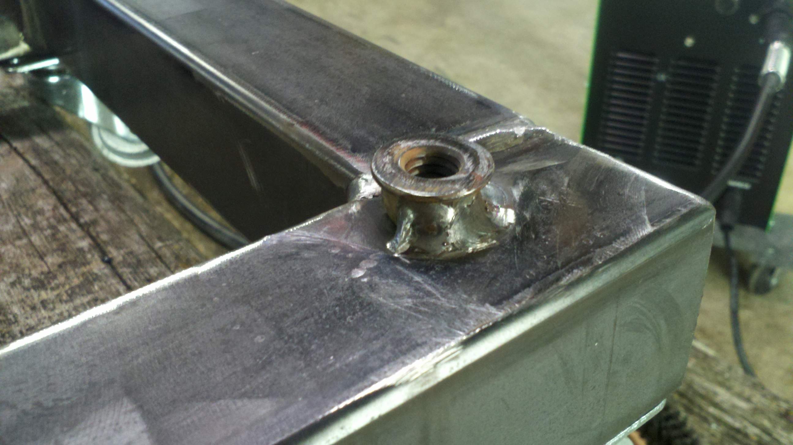

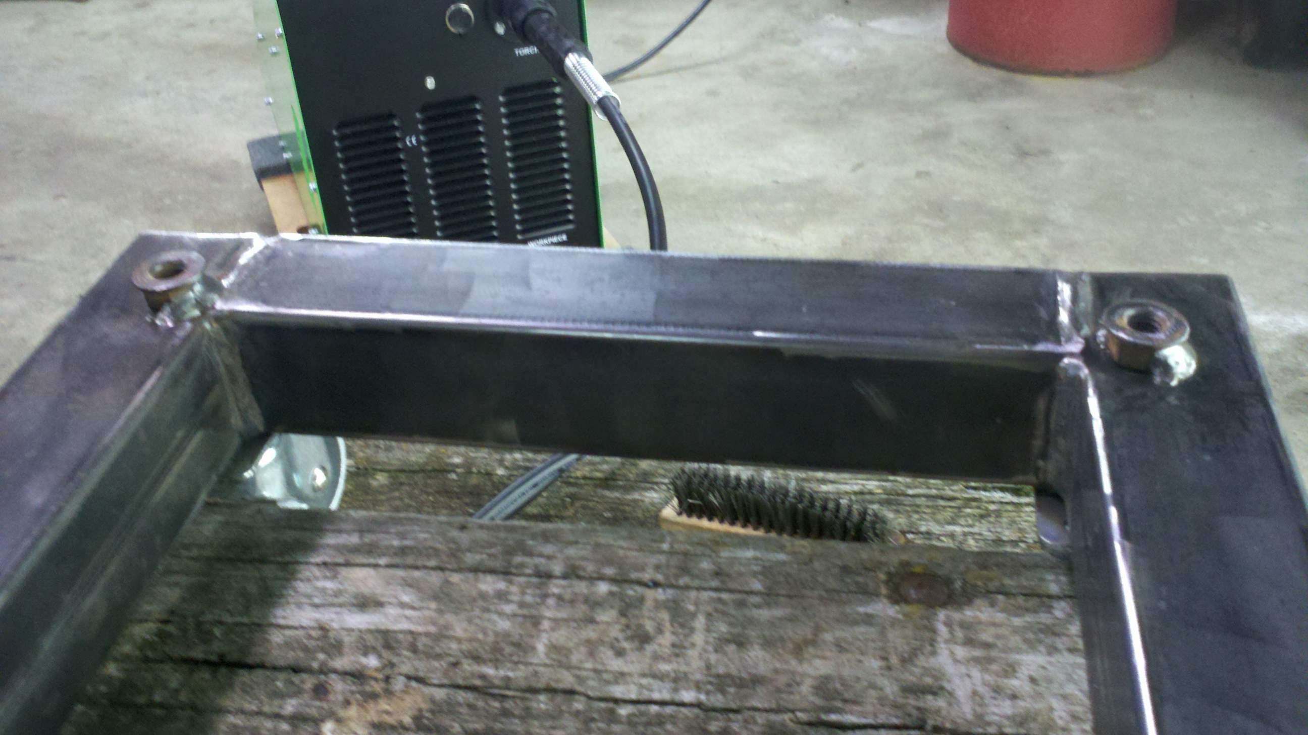

A couple of pictures of the cart work today.
I welded on 4 nuts that the welder will rest on at each corner.
