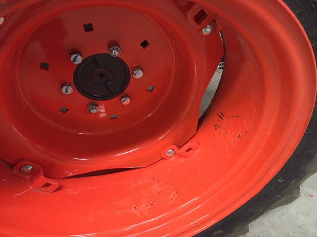

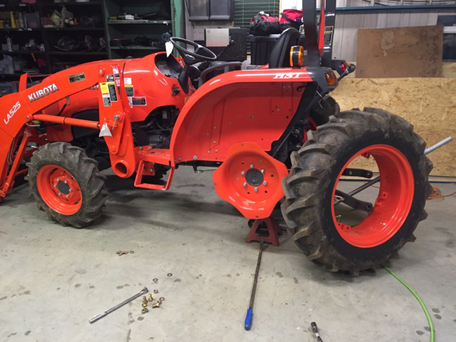

My Kubota with AG tires had adjustable rims.
There is about 3-4" of adjustment in the rims.
I just bought wheel spacers that are 3".
Just on the science theory, which way would make the tractor more stable on a side hill?
Say the outer part of the tires touching the ground is 65" as a baseline with both settings.
With the "rim" sticking out past the end of axle or the end of the axle/spacer sticking out past the "centerline" of the tire vertically,
Causing a bit of cantilever. Which would be more stable in respect to the center of gravity overturning the tractor on a side slope.
Yes I know. Both is better.
Inquiring minds want to know. I know some of you will ponder this. **** OCD!

I made spacers to fit between the center dish, and the outter rim. The added load from the additional leverage was factored into my decision to do so, my thinking that the wear on bearing was cheaper to repair than damage to my head if I rolled on my steep hillsides. I've also built a full cage ROPS.
I realize this has gone beyond the original of one vs the other, but...

Addressing the bearing load only, I don't think that the "cantilever" has any effect on the bearing.
For example, it the bearing located at the outer end of the transmission stub is normally loaded to 1000# for example, it doesn't matter if the wheel is at 1" or 10', the load on the bearing is still 1000#. Cantilever does not change the load. It would affect the axle only.
   / A physics question of leverage #35
Correct. It becomes a question of if your axle shafts can handle the load.

No. The 1000# load is borne as a torque acting via the axle; upward on the outer axle bearing and downward on the inner. The further out the wheel the more the force on each bearing. The outer bearing sees 1000# more.
   / A physics question of leverage #37
So if it had 1000# before, where does the additional load come from. Did the tractor get heavier?
   / A physics question of leverage #38
Additional load comes from additional torque as the wheel is relocated further out.
   / A physics question of leverage #39
The total load stays the same. The internal bearing forces will change.
