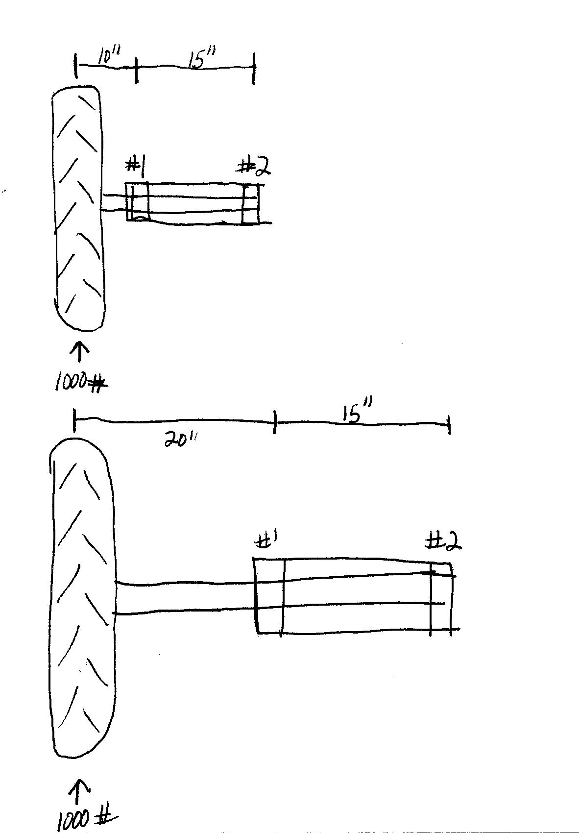

Are you saying the load at the bearings is the same on the top drawing as they are on the bottom?
   / A physics question of leverage #78
Yes. When the upward force reaches 1000# at the bearing, the static load amount, the tractor begins to rotate. The force cannot exceed 1000#, it can only match it. Newtons Third law - To every action (force applied) there is an equal but opposite reaction (equal force applied in the opposite direction).
   / A physics question of leverage #79
You need to re-think that then.
1000# pushing up on a tire/axle 10" from outboard bearing and 25" from inboard bearing somehow has the same bearing load as...
1000# pushing up on a tire/axle 20" from outboard bearing and 35" from inboard bearing......
Since when did leverage no longer apply? Leverage makes the load.....in both cases.....exceed 1000# on the outboard bearing. It just exceeds it by a greater amount on the one with the longer lever arm.
   / A physics question of leverage #80
Leverage never applied. Forget that premise. That is something that numerous people confused themselves with. We're not moving an immobile rock here. It's strictly an action and reaction situation on the bearing. Do you think Newton is wrong?
