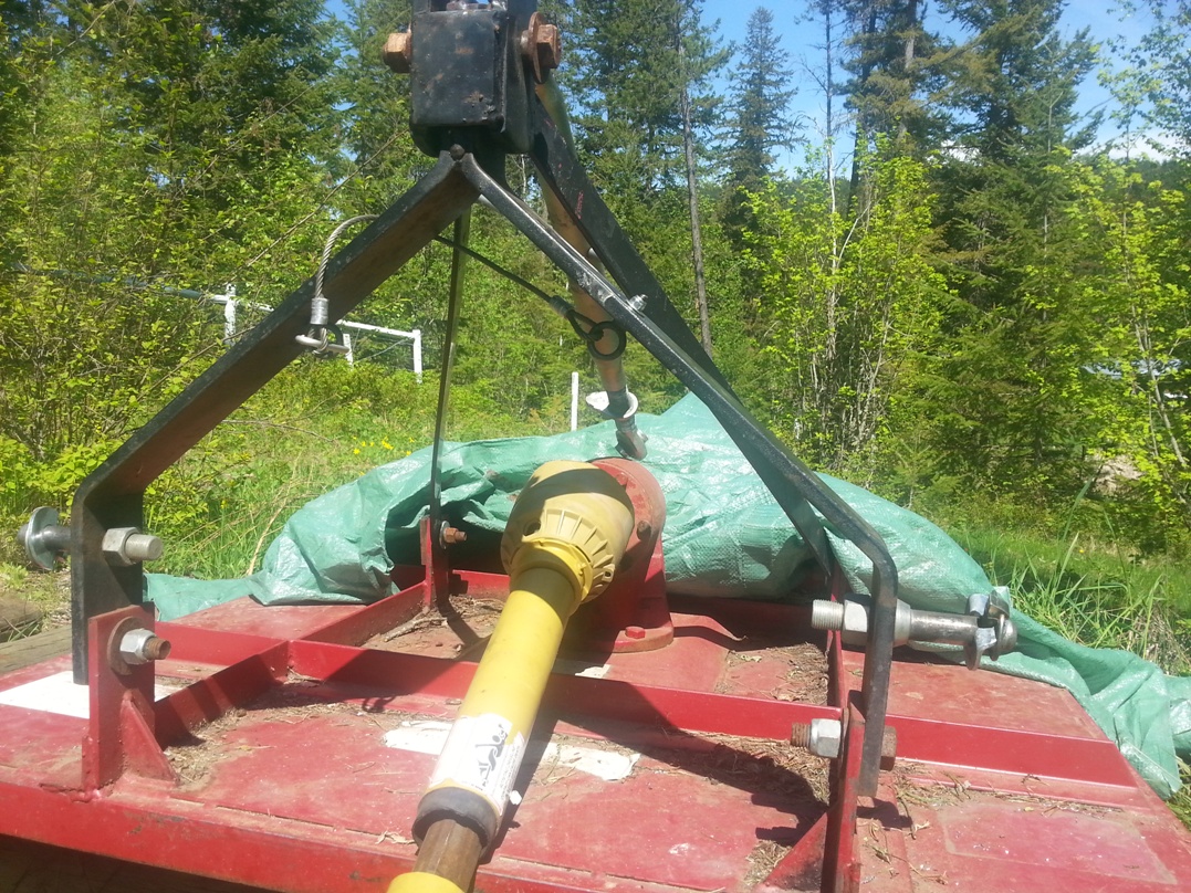

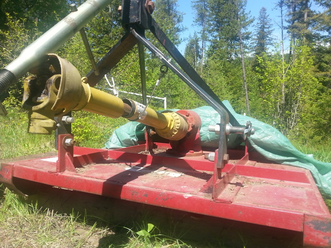

I had a couple of eye bolts and caribiner on hand to make a hanger for my rotary mower PTO shaft. I still plan to add a second bolt on the left arm in the photo to attach a shear pin holder. I need to get more bolts to make a hanger for the finish mower.

View attachment 375215 View attachment 375216
Yep simple solution to a problem.. Wow... makes you wonder why you didn't do that 10 years ago:cool2:

That's for sure! Your post is what finally motivated to do something. I will make one for the finish mower next and then the snowblower.
Thanks for the ideas.

Your very welcome!. Sometimes all it takes is a little push and seeing someone else do something to get us to act. Your solution would probably work even in a "tight" space like a tiller, and it sure is a simple self storing solution.
