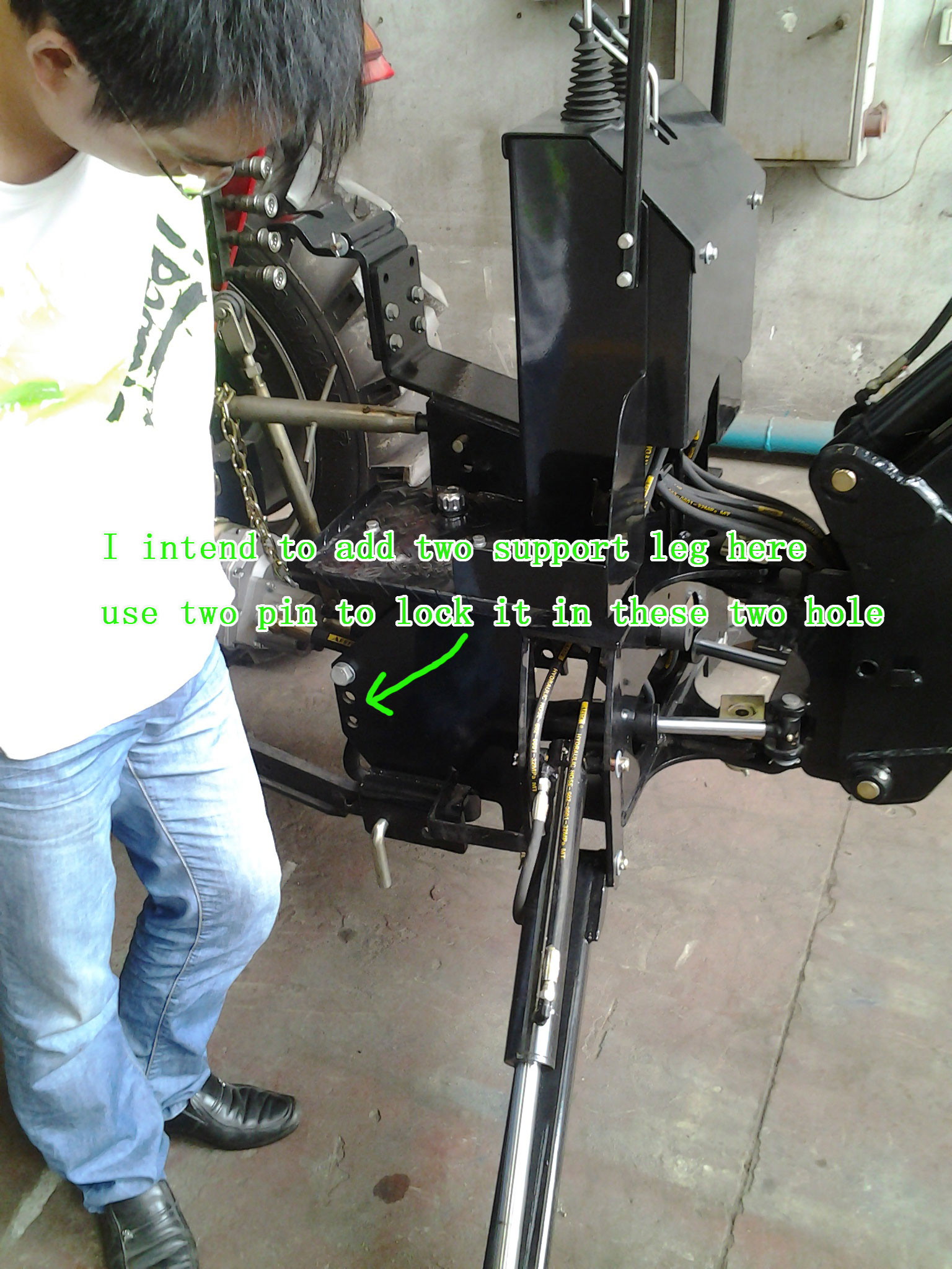

Yes, in fact, I already have plan to add support leg for it.
so is your backhoe foreign brand? I mean if it is not from China.

Thank you everyone, I think I need to updata my backhoe manual, I will show you photo after we produce the support leg.

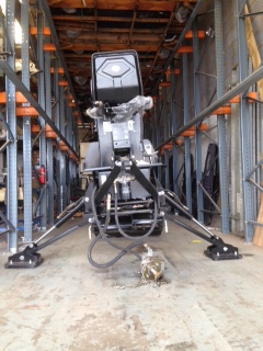

I made many support leg for backhoe storage, here is the photo which I took from our workshop. the backhoe now is standing by those two steel legs, not by its cylinder leg.
