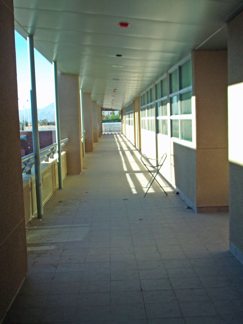

Dave - I went by one of my projects today, a high school, and looked at the tile on the second floor exterior walkways. It also is a porcelain tile and to my surprise we have runs of almost 200' without a single expansion joint and standard grout in the joints. We have been using this same detail for several years now without any problems with tile coming loose.
Our winter temps are close to or slightly below freezing and summer will hit 120+. The kicker is that we pour 2" of light weight concrete over a steel deck. Tile is then thin set.

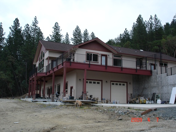

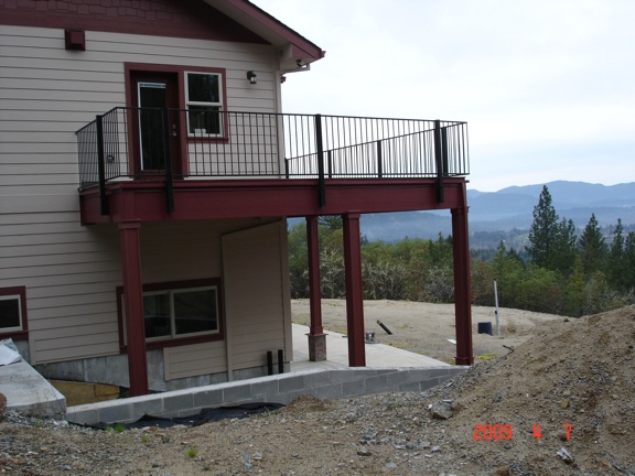

Anyway I am attaching pictures of the deck, more in the next post.

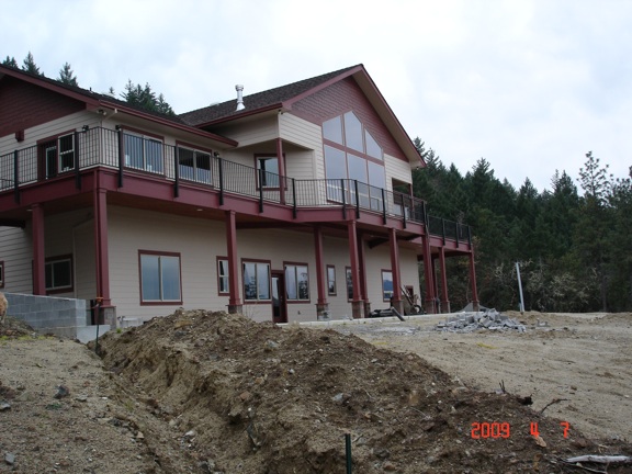

Some decks are covered others only partially and all are soffited below, but otherwise open to the weather.

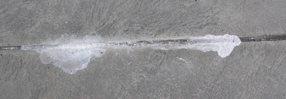

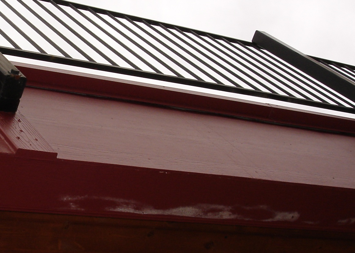

Some of the things that make me feel good is that last year the efflourescence on the bottom of the headers was much, much worse than this year. Almost continuous along the bottom of the headers. The cause of these deposits is water coming through the tile, down the back of the headers, and evaporating from the bottom of the header.
Also, last year the grout was missing, as in totally gone, not just deteriorated, from about half the deck area, this year it is much better. And the efflourescence on the surface of the deck is much, much less than last year.
