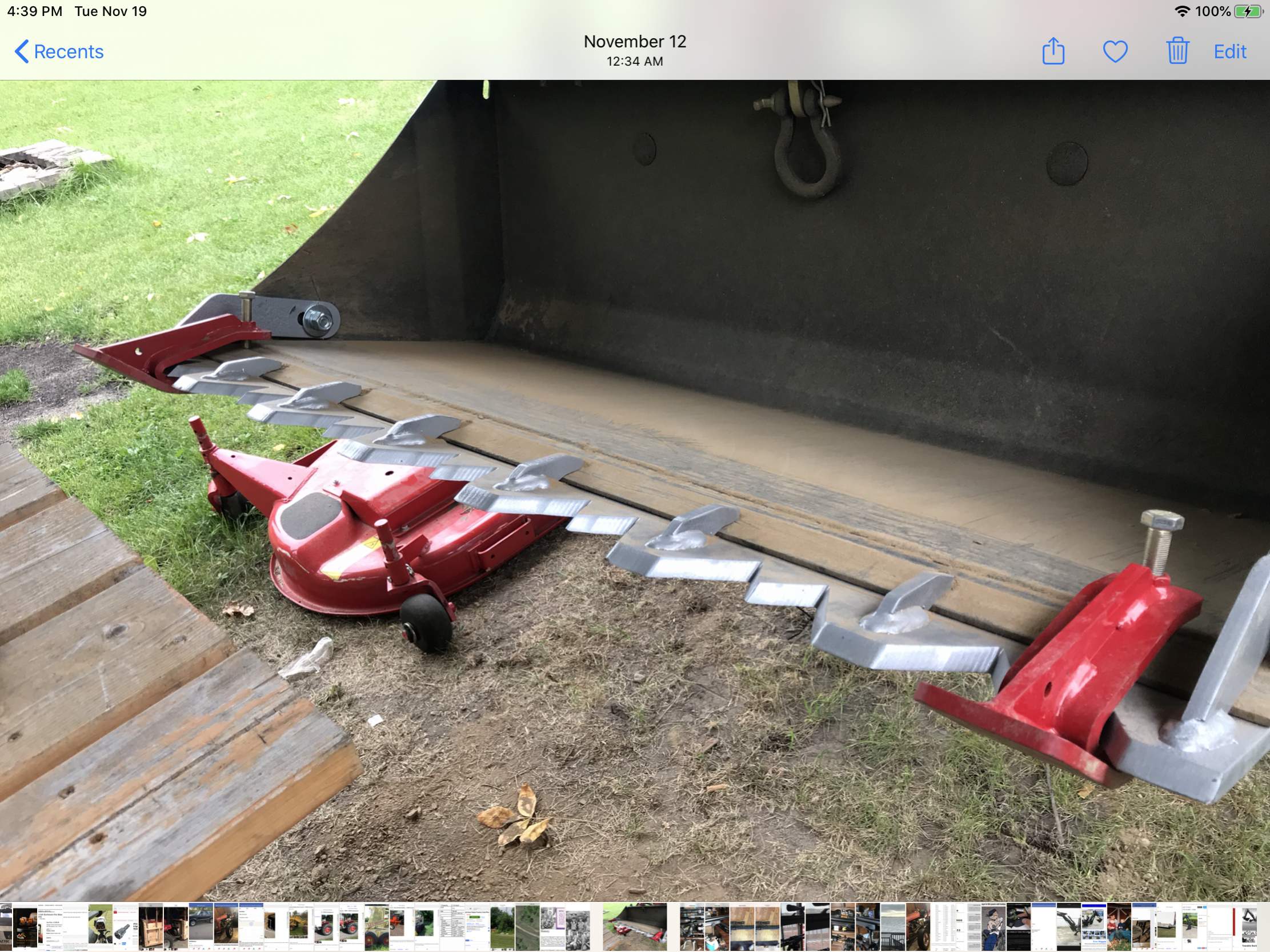

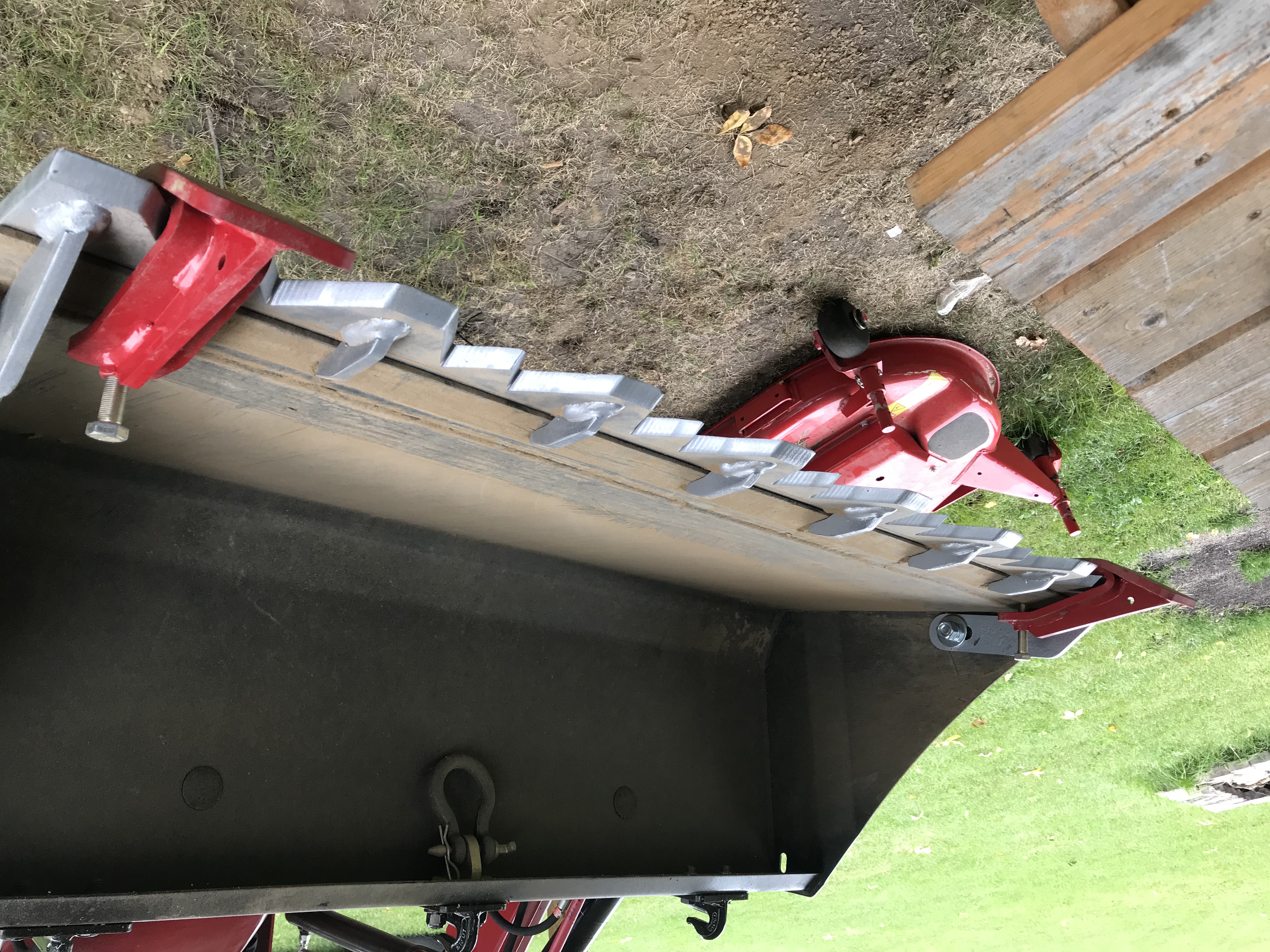

The Tamers fit over the piranha bar so now I can leave the bar on all year round if I want.
I did not know both could be left on at the same time, thanks ! I really do need to get a set of tamers to keep me from destroying the grass each winter.
Not sure if it will work on all buckets but it did on mine, one person had his piranha bar made with a tooth cut out on each end so his tamer fit on.
