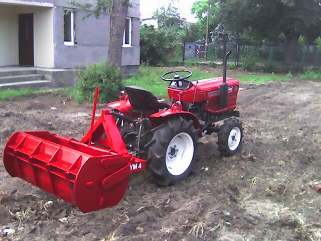

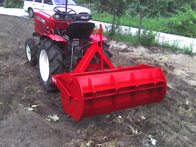

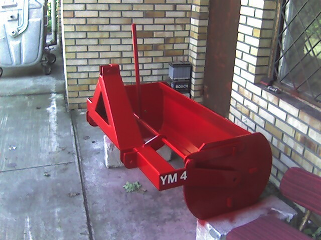

I had a day to work on the imitation Gannon this week so I took the scarifiers to a friend for some hard facing (My tiny little welder does not have the omph necessary), but I finished boxing in the 3 pt mast for strength. I believe that it will hold 50 horses and not just my 15. :D
I sanded it all with a flap disk, sprayed some primer on it and then some Yanmar Red. I even put a model number on it. YM 4R for 4 feet width and R for Rollover. (R is still in the making) Makes sense anyway to me. :rolleyes:
I am very happy with the result of my project and had a lot of fun building it--besides I have already used it to do some of the work for which I made it, as you can see in the pictures.
I hope that you have enjoyed following along and look forward to "seeing you" again in the near future. I need a small trailer to haul all my toys around on.:eek:
Have a good one,
Mike in Warsaw
