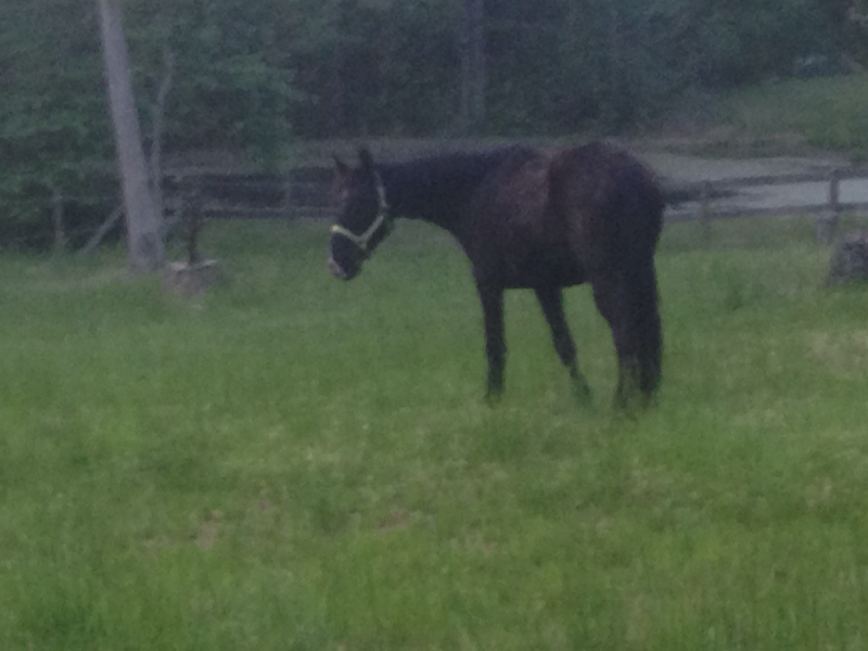

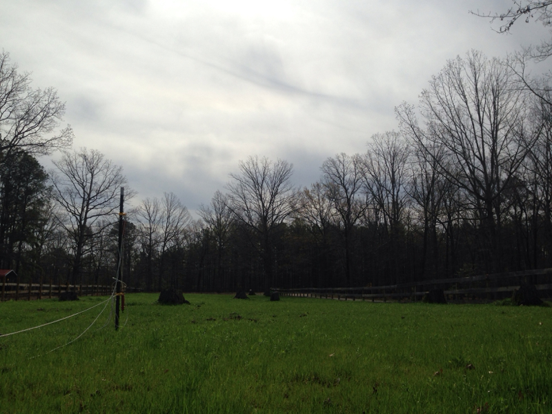

Yes I plan to seed around Labor Day. I will disc it but I'm not sure I could get clover or buckwheat started in the summer here. I have never tried it.
I have had good luck at my place seeding in September. Last year I cut what I seeded 3 times before the frost. I seed then I turn horses loose on it for a week or two depending on the rain. Here are some pics of what I've done. The first one was all wooded 4 years ago when I moved in.

You could probably get buckwheat established pretty easily. It requires warmer temps to germinate and unless you get some really hot summer temps than sun hemp could be an option. I know Hancock seed sells it. Highly competitive to overwhelm weeds, adds a ton of organic matter and adds N to the soil. Nice work on the wood pasture thats an impressive stand for first year planting. If you got soil like that you may not even need a cover crop. Personally I would still go with one though. Horses are pretty heavy animals so you might have a touch of hard pan in the soil so your going to most likely have to work it up at least a little bit.
