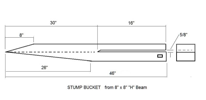

   / A "Shovel Ready" project! #28
I need some help.
I've built a Stump Bucket / Trencher / Spade and I'm 700 miles from my tractor, a Kubota L3901.
I had a piece of 1/2" thick 8" x 8" "H" beam...and my cutting ability is better than my welding ability. So, it is the beam, pointed and slotted for the front end loader. I like that the piece under the loader is long as I think it will protect the bucket. The square slot on the left end is for a chain to attach to tractor.
If this works, it will have cost me the electric for the plasma cutter, the hair I caught fire and some paint.
Buddy looks at it and says the slot for the FL isn't wide enough...my slot is 5/8". anyone know how thick the cutting edge on a kubota FL model L525 is?
It's done, except maybe the slot. Sorry I don't have a pic, but promise to post one.
Thanks
DAD

You need someone that has one to actually measure their Kubota La 525 loader for you. I could guess, and I am a little concerned by the 5/8 too. Maybe OK.. not sure. I don't have one to measure.. but there is a thick reinforcing rib in a couple of places I think... So it might depend on where you put it.

Cannot help you with the Kubota model you have but my similarly sized Kioti DK40se has a cutting edge that is 1/2" so a 5/8" slit would be perfect. If it doesn't fit your tractor, UPS it to me.:thumbsup:
