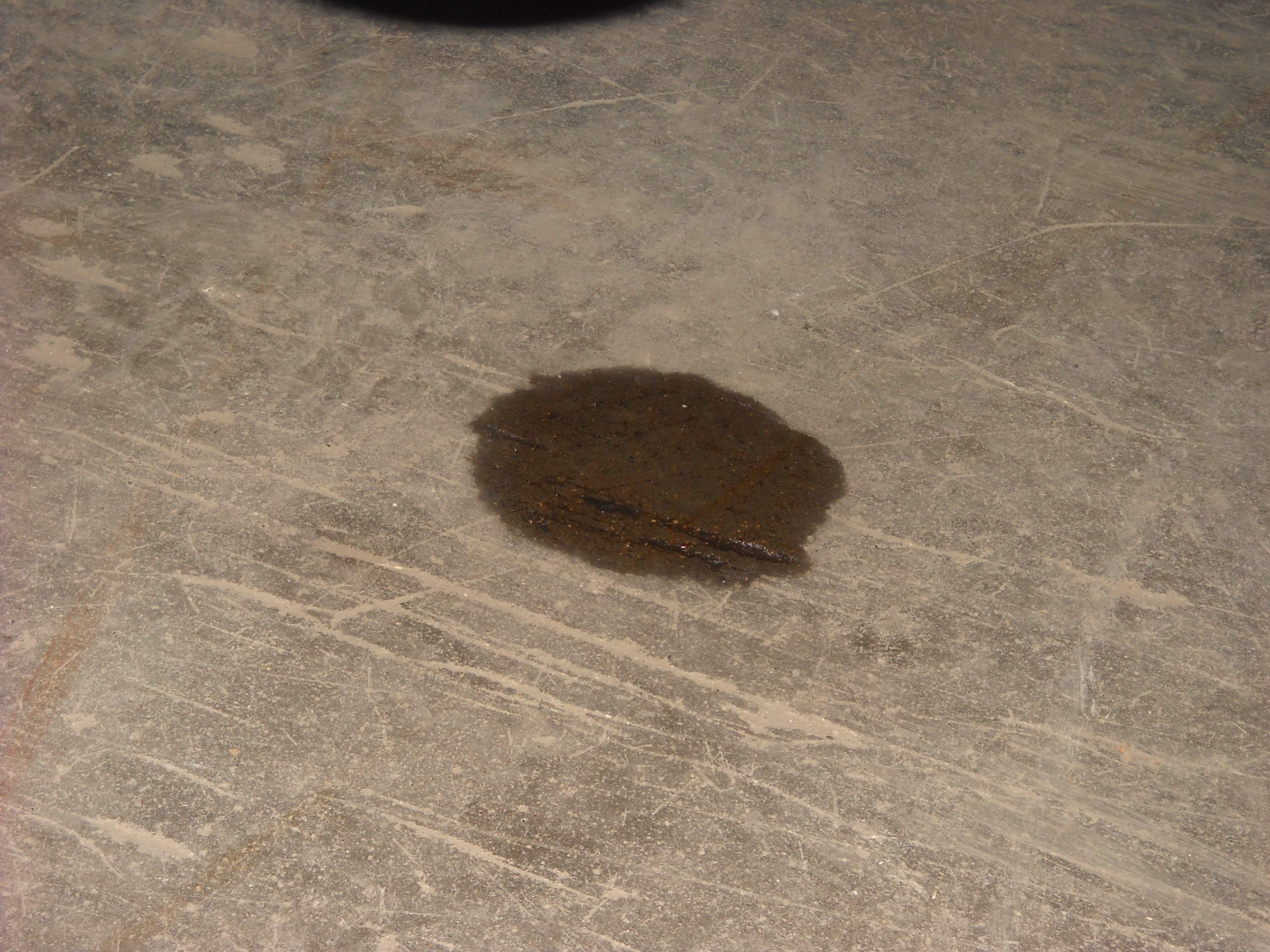

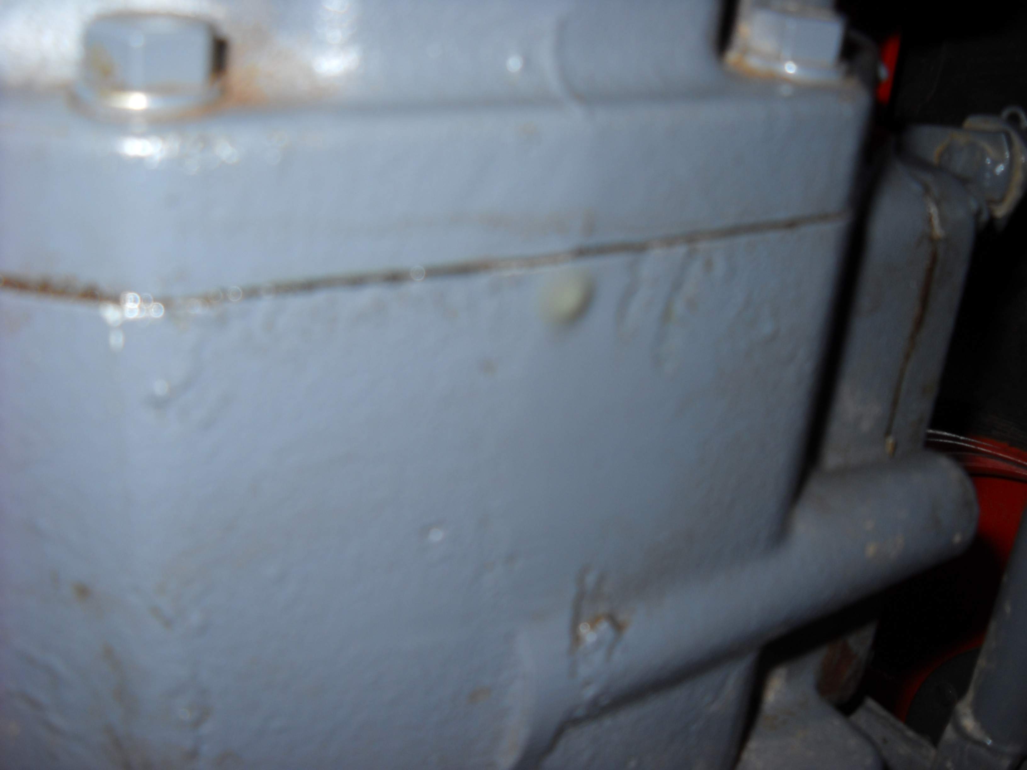

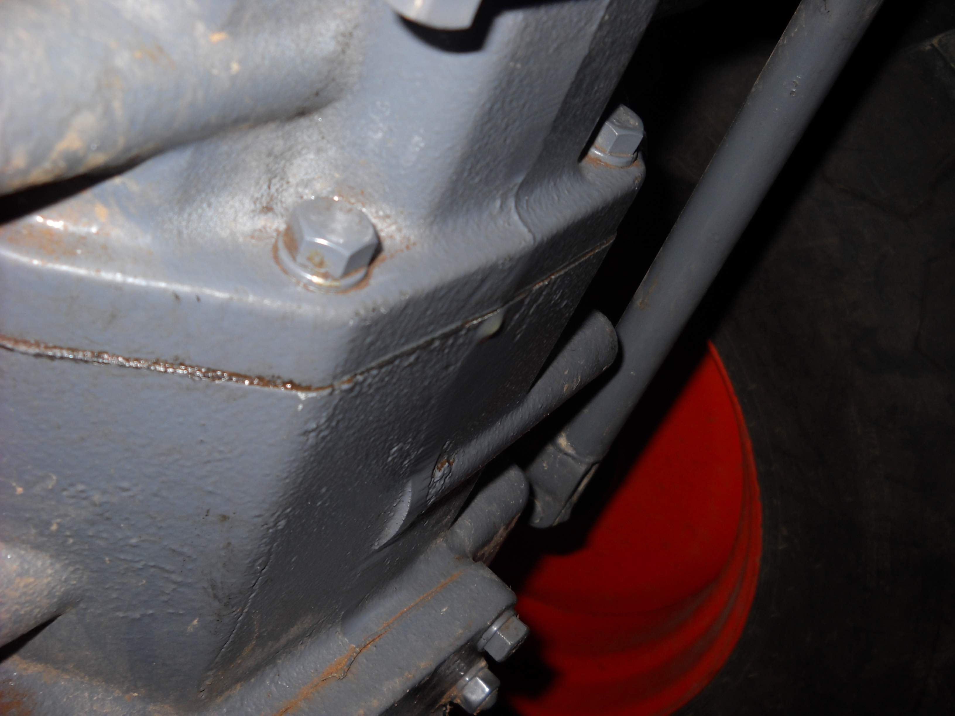

I brought my tractor home to work on the 50 hour maintenance and discovered it has sprung a small leak. See pictures. The dealer is coming to get the tractor on Friday. They were as supprise as I when I call them about it. Has anyone had this problem? You can't see it to well in the pictures, but theres gasket material coming out on the right side and left side.

The close in shot makes it hard to tell what the part is. I think it is at the back of the tractor. If so, the rear lubrication, and hydraulics may just be overfull. However, this is just a guess.
/ A Small Leak #3
Then again, if this is the front axle, the fluid (hydraulic or 90W), may just be overfilled. The font axle is either filled to a level one can see through a peep hole, or filled to the bottom of the weep hole. On my CK35, the weep hole is located on the "driverside" axle about 2/3s the way up.
/ A Small Leak
It's at the back of the tractor by the gray filter. It's where the front and the back of the tractor come together. Major problem? I'm not sure.
/ A Small Leak #5
Holy smokes! Mine is doing the same thing only is has 800 hours and the puddle is bigger. The leak appears to be from that joint between the transmission and the rear end. I am very interested to find out how this goes as mine has been leaking for months. I am thinking that my hydro fluid reservoir is overfull somehow. This is not a pressure leak, it will leak at the same rate whether the machine is running or not. So far it has just made a mess but no change in operation.

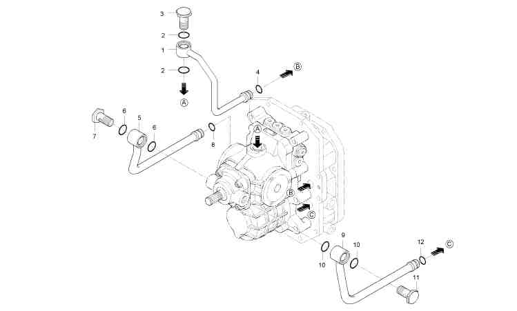

I seen it before..
If you ask me I would say that the hst charge pump steel pipe o-rings are leaking.
/ A Small Leak #9
Wallace, which O-rings are they? Are they external? Can't tell from the diagram which seal you think is the culprit.
/ A Small Leak #10
The one I did a few years ago was #12
/ A Small Leak #12
Yes
It's not really a bad job at all once you remove the floorboards everything is in the open.
Take your loader off first it will help when rolling the front half away from the rear.
Make sure you have 2 floor jacks and 4 jack stands.
If you are in there and find a bad o-ring make sure when reassembling you put some grease or lube on the o-rings.
The one I did was brand new out of the crate and the o-ring was nicked during the assembly process.
I also had one on a different color machine that when they welded the fitting onto the steel pipe there was a pin hole in the factory weld job:mad:

Wallace, sorry if I am not seeing the big picture, but couldn't you just remove #11 and pull #9 back and replace the o-ring? I am only basing this on your picture and I don't really know what stuff is built around these tubes that would make it a tractor splitting project. Just trying to expand knowledge. I know I have spent days trying to fix something and not taking other things off a machine, finally relenting and tearing the thing completely apart. It probably would have been faster if I had done that in the first place. Sometimes you work harder trying to avoid work! ;)
/ A Small Leak #16
The hst pump is in side of the trans case those pipes are going in to the rear end case.

They (M&M Express)droped off my tractor yesterday afternoon. They replaced the gasket between the tranny and the rear-end and serveral little O-rings. Its as good as new. Wow, what service! Should I be replacing the Hydro filter again after a few hours? I didn't ask them this question.
