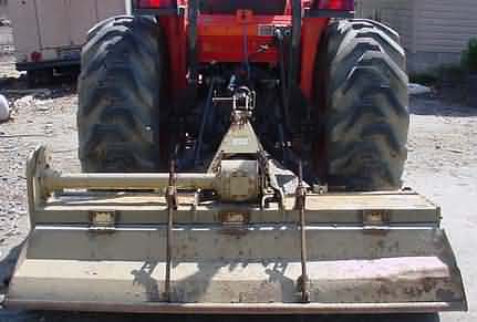

I've got an L4310hst and have a Landpride RTA2570 tiller it does just fine behind the 4310.
HST is the key in real clay soil being able to slow down and not overload the tiller. When I first got the tiller I had my trusty ole L3750 and it wasn't hst. I had more trouble getting the ground speed correct versus tilling conditions. Don't miss that ole hydraulic shuttle shift a bit. But that ole tractor had alot of memories with it./w3tcompact/icons/smile.gif
I've attached a picture of the tiller behind my tractor it's the perfect size. I wouldn't want anything smaller.
Gordon
