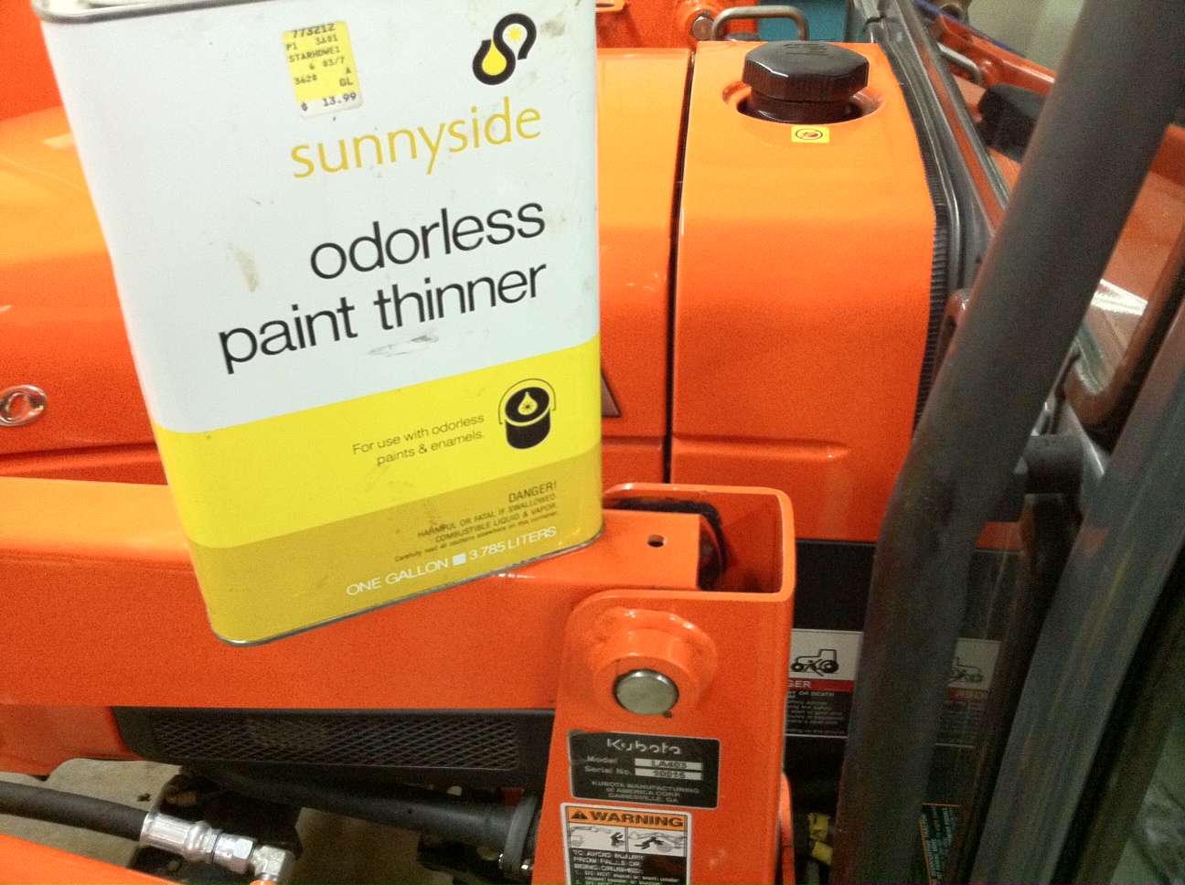

. It's lacquer thinner or xylene ya don't want to use
I used "goof off" which has xylene in it. to remove the top layer of finish on the floorboard when I put the truck bed coating on them. It removed a little of the paint, which was my intent. I used white paper towels to rub it down, and they were a little orange when I got done. I sure would not use it on my hood.:laughing:

Where do you buy the odorless thinner?? Lowe's??
Deano
Hi Deano I got mine at Star hardware but I'm sure Lowe's will have something.
Just make sure it's odorless unless you like working with the smell of solvents.
You can use it for degreasing anything on the tractor. Just remember it's flammable. Keep the used rags outside or in a small metal trash can.

I have a box of those cheap latex gloves that I use every-time I grease or clean the the grease on my tractor. My grease gun always makes a mess and this red grease sticks to everything. It never fails somehow the grease gun extension hose gets me and everything else every-time. When I'm done I just peel the gloves off and throw them away.
WD 40 is great for spraying on and leaving it on for protection but is a poor cleaner compared to this. it doesn't dissolve the grease as well and it doesn't leave a clean Wax-able :D finish behind and I can't take the smell after awhile.
I buy a "box of rags" that's what its called at the hardware store. Its cotton tee shirts. I pour a good amount of this odorless stuff onto the rag and just "wipe" the grease away. The grease dissolves and sticks to the tee shirt and doesn't smear it all around.
This brand paint thinner is very mild and seems more like white kerosine than paint thinner. I say that because its more oily than lacquer thinner I have no experience with other brands.
