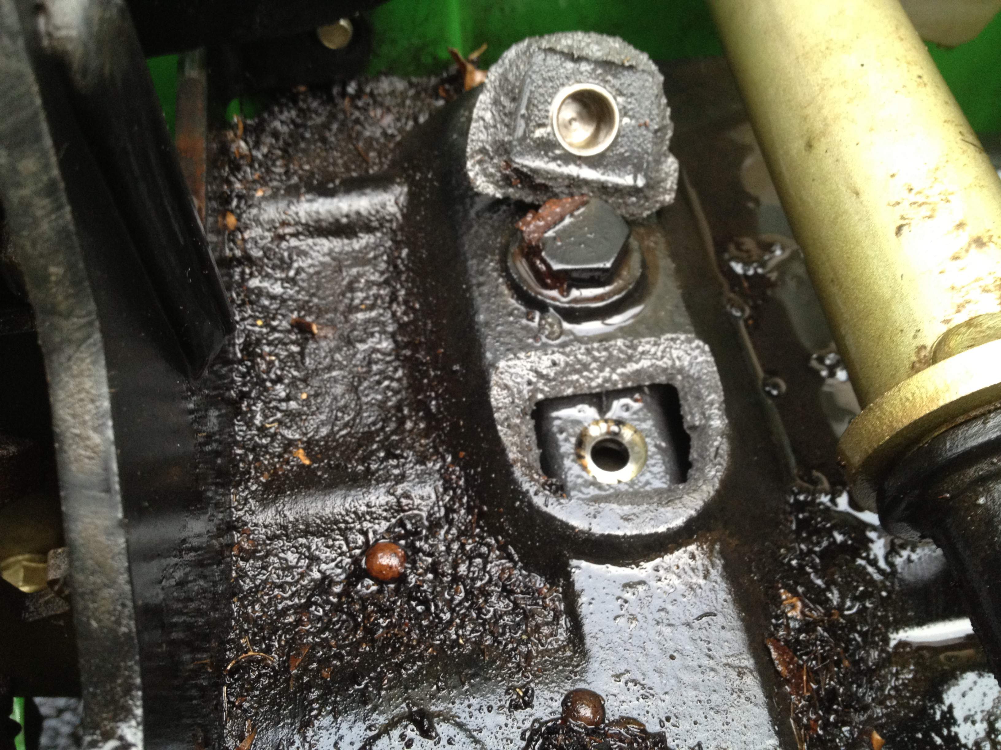

Well, I found the problem. The top of the SCV just blew right off! I know it sounds crazy, but a big chunk of metal blasted off, as opposed to a fitting or a hose blowing. WOW.

That is a WOW for sure.
Would you post a pic from a bit further back so we can see where this broken casting sits?
Is there a matching piece under the broken piece? One mounting bolt between?
I would expect Deere will replace that part for you.
Is this the part that broke? That gold piece laying there is throwing me off. :)

Yes that is the part. The tractor is well out of warranty, so I'm not holding my breath on Deere covering the part. I'll certainly press the issue though. The gold part connects my additional hydraulics controller to it's valve (I have a clamshell bucket which this controls)
   / A way to isolate the loader control? #19
That addition of the clamshell controller may take it out of replacement by Deere, but it doesn't seem to be a typical failure of good cast parts.
I'd not be surprised if Deere doesn't replace the part at least, so they can inspect the broken part.
