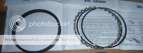

Hello , sorry about the delay in getting back to you all. I appriciate all the help on here. I did call my Massey dealer here and he said to use what came with the kit. He said they used 5 different scrapper rings in these engines. So that being said I went on with the rebuild. My next question is: I would like to start my engine before installing in my tractor. Have any of you done this? The way i see it, is to build a crib, Run fuel to the lift pump. Bleed air from inj pump and injectors, and run a return from my injector to the supply tank. Of course run lines from water pump to a tank and hook up oil and temp gauge. Does this sound right?

G'Day curt3969 .
The a3.152 is an indirect injection type engine.
The Massey 35 with engine number up to 1935854 should be fitted with Finished CAST liners, and piston rings oem part number 836325 M91.
The Massey 35 with engine number from 1935893 should be fitted with Finished CHROME LINERS ,and piston rings oem part number 841521 M91.
The cast ring set has the top or compression ring that is chrome plated and if it was fitted to the chrome liner it would very quickly fail on startup ,symptoms being excessive smoke high oil consumption and eventually the ring would seize in the bore.
CAST RINGS IN THE CHROME LINER ONLY.

I found that some of these kits come with liners that need machined and others that are correct,also the same for the pistons. I am lucky to have a worked in a machine shop that rebuilt many Diesel engines and gained a good bit of experience there. But I left the machine work to a good machine shop here with alot of diesel experience and feel confident with the liners. I mic'd them up and they were right on size. I just was not sure of the piston rings they gave me. I have the engine back together and finished the Cylinder head tonight. I have to run and get a couple of other parts this weekend and cant wait to start it. really enjoy the input from everyone and hope to learn from all the experience they have to give. Thanks again.

By gapping the rings, I was referring to fitting them to the bore. I've always called it gapping the rings, thus one is setting their end gaps when they are fitted in the bore. Similarly, I've always called staggering the ring gaps on the piston "clocking" them, because the gap positions resemble the varying positions of the hands on a clock.

I am sure you would have checked when rebuilding the engine but just a mention when fitting the expander type ,three piece oil control ring,the expander is installed first then one of the oil control rings,it is important that the Painted ends of the expander BUTT UP TO EACH OTHER that is they do not overlap when the rings are fitted you can look and see the coloured ends that BUTT up together.
I just thought it worth a mention as I had a Massey 188 That was using oil pretty bad after the owner had a friend rebuild the engine and this was the problem ,the expander on all four ring sets were overlapped , consuequently the rings were not being tensioned properly and allowing oil to pass into the combustion area and out the chimney in a liquid form, lots of smoke and oil everywhere.
