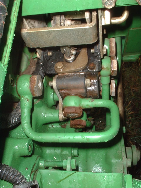

Here are some pics of the JD790 hydraulic lines showing the banjo fittings if anyone is interested. The banjo fittings are at both ends of the green painted line shaped like a G laying on its back. The connection to the left is apparently pressure from the rockshaft housing, and the other end is the power line into the FEL control valve. The wrench size is 1.062" or 1 - 1/16". As we've said the bolt is a 3/4x16 straight thread.
I managed to order some right angle fittings that will be SAE8 O-Ring Males on one end and 1/2" tubing flareless bite fittings on the other end. Not cheap though, cost about $10 each! I can use these to replace this line with the lines that will feed the supply lines to my new TNT valve. I want to run the supply lines to the new valve in solid tubing and use hoses for the cylinder lines. So these are before pics, hopefully I will have some after shots in a week or two /forums/images/graemlins/wink.gif

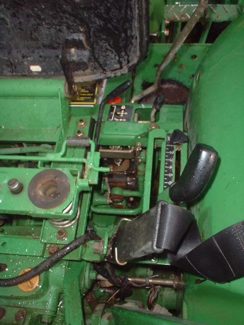

Here is a view pulled back a couple of feet from the previous post so you can still see that line with the banjo fittings, but you can see that it is visible down between the seat and the right fender. The 3pt control lever and seat belt are right there. Getting at all this plumbing will require taking the seat out and the fender off and some of the other sheet metal around the controller. May even decide to take the wheel off and put the rig on jack stands. (The tires aren't filled, planning to cut up some steel weights, another project)
The lower port under the power connection to the FEL SCV is the tank return line and will probably require unbolting the FEL SCV to screw on the new right angle SAE8 fittings. Not enough clearance to spint the 90 ell in otherwise.
Anytway this gives you an idea where all this plumbing goes.
