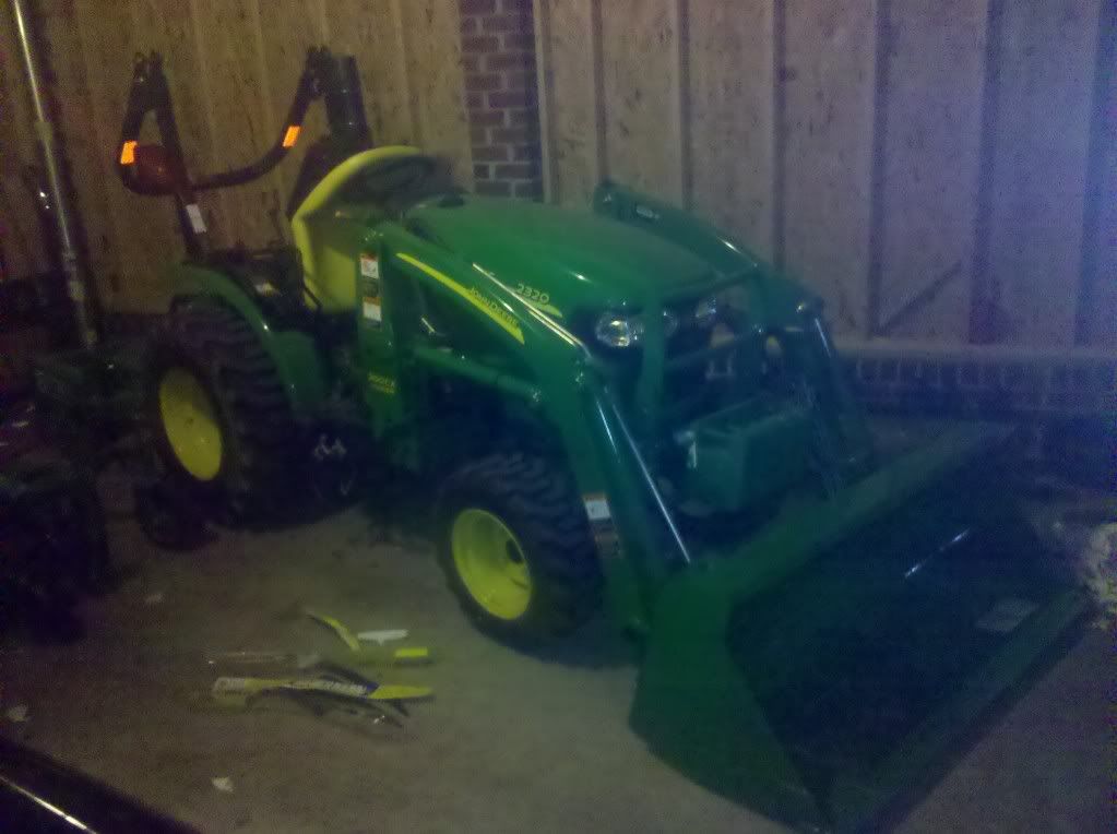

It was delivered this afternoon, The wife and I mowed about 3/4 of our yard and I filled in a couple holes in my yard. here is a pic of it tucked into bed for the night:
