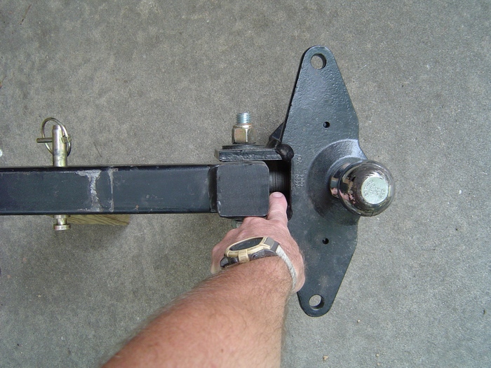

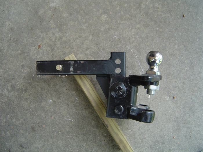

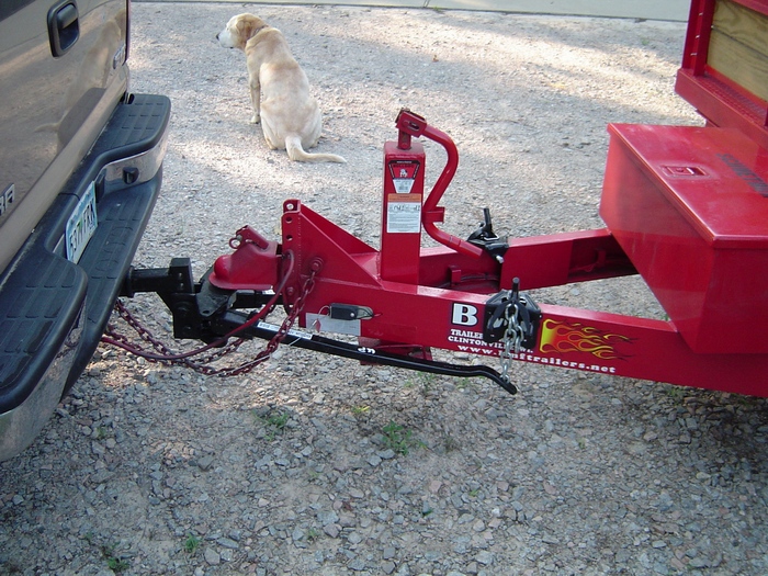

Tony...I took some pics to show you what I mean about adjusting your WDH using the shims.
1st pic...Shows me pointing to the shims. The shims, (washers), go onto a bolt like piece which holds them in place between the shank and WD head. You can vary the number of shims in there, depending on your vehicle/trailer combo.
2nd pic...Shows how the shims cause the WD head, (and trailer ball), to be angled...that causes the WD spring arms, (when attached to the head), to be aimed more at the ground or downward. Since the WD spring arms have more distance from the trailer tongue, you can draw up further on the chains. That makes the spring arms take more weight.
3rd pic...Everything assembled, now take notice how the WD head is angled on the truck, (like it's looking more at the ground), and the chains are pretty short, but not enough to let the spring arms hit the trailer tongue when turning. By angling the WD head that way with the shims...and shortening the chains...it causes more trailer tongue weight to be transferred to the front wheels of your truck. It is in effect a fulcrum! Now also take notice how the dog is angled from the truck...

Dave and Bird, Its more clear about changing the angle of the WD head. Dave I have a different setup than yours. I think mine is a Draw-Tite Pro Series. The labels only show Pro Series. As I checked the angle of the head, mounted in the truck receiver, It very close to 90 degrees,(level, straight out from the reciever)) possibly turning up slightly. (Dave, opposite from your photos) By rotating a six sided washer,(different length sides) one on each side of the head, it will create different angles. If I angle it down, will this raise the rear of my truck up when I mount the WDH? My goal is to reduce the truck sag while keeping the trailer level. Dave, I learned a lot from your post and all the replies you received. I should forward this entire thread to my dealer.
