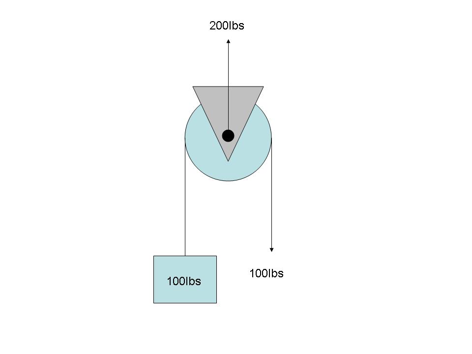

But what about friction?:D :D and what does the rope weigh? Pulley weight???
   / About Weight Distribution Hitches...pics etc. #42
#43
200 pounds total weight applied to the pulley. The weight itself is 100 lbs. The force on the other end of the rope to lift the 100 lb weight is 100 lbs. 100 + 100 = 200.
