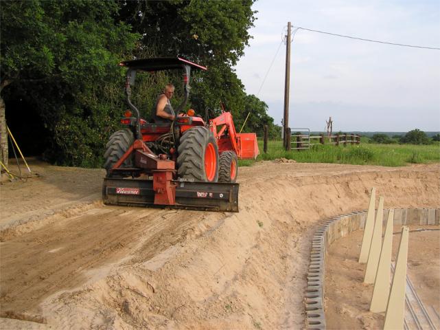

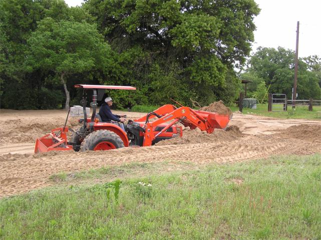

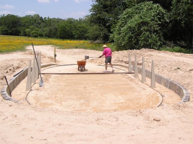

Renob, I'm in the middle of installing my above ground pool.
A good book is "The Ultimate Guide to Above-Ground Pools" by Terry Tamminen.
I will be watching this thread closely for advice also.
To blend the pool into the countryside, and since I have the time for fun projects, I am putting the pool below ground level and will have a deck. I am designing it as I go along.
The pool company would charge $1,500 to install plus $500 for each foot lower than ground level. FYI
The advice given so far is good. A laser level is a good tool to have to get the bottom level. You cannot be more than an inch off.
I had to run a 20 amp outlet to the other side of the pool for the pump/filter With the southerly wind I put the skimmer on the north side.
My pool is oval, 18' by 34'.
Hickorynut, the way you described the installation of the liner is exactly how the instruction say to do it. When I asked the installers how they did it they said they just make sure wrinkles are out and fill it up.
Attached are few photos of my "FUN" project.
Picture 1 digging the hole.
Picture 2 smoothing the ground.
Picture 3 - Yesterday I did the final grade by hand and used some concrete tools to get the sand smooth. I got lucky on this site, I only hit rocks on 1/3 of the site.
