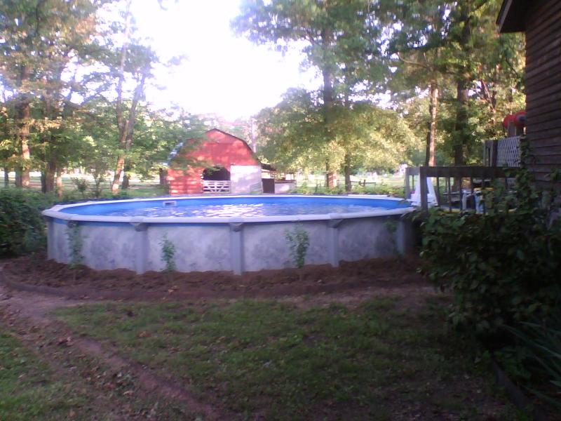

Step 24 is filling the pool with water, finally.
It took 2 days and this evening the pool is full.
(The wrinkles came out.)
This is a tough job with just 2 people, but it can be done.
The pool came with an underwater light kit called the Hayward Elite underwater quartz halogen flood light for above ground pools. It is an excellent addition and easy to install. The kit included a tool to make a perfect cut in the side of the metal wall.
Next project deck.

/ Above Ground Pool Install #50
Hot diggity Don! That pool looks pretty darn nice.:)
...course I wonder how long it will be before we see pictures of a few snakes swimmin' in it.:D
