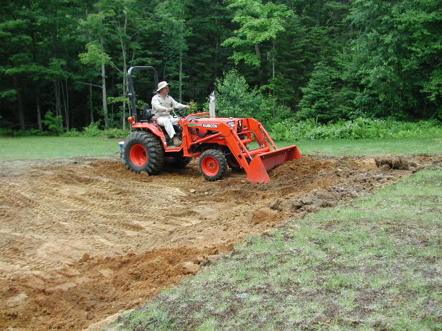

Well after getting a lot of info from TBNers I have decided to take the plunge ( pun intended ). I am going to install a 15X30X52 oval, above ground pool. I went to Home Depot and bought enough underground 10/2 wire to go the 180+' from a 20 amp breaker in the house to an insulated GFI plug on a post by the pool. I will be running a 1 1/2 HP pump with a 200 lb sand filter. I went to a couple of local dealers and decided I could get a much better deal on line. So I plan to order the pool from yourpool.com .Being that I live in the Granite State (NH). I have already dug up enough stones for a new wall! I have to cut into a slope to get a level area. So I will be getting a lot of seat time. I dug from 8-4 today. Sure am glad I bought the tooth bar! Here are some picts of day one of the pool project. I will post more as I progress. Wish me luck!David

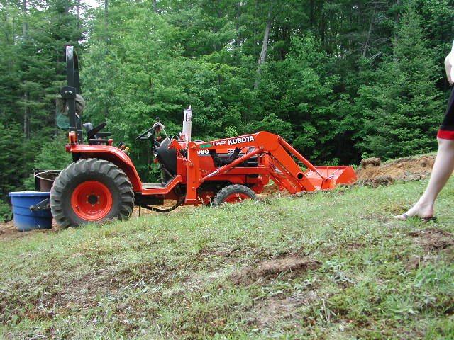

This pict shows the slope .
