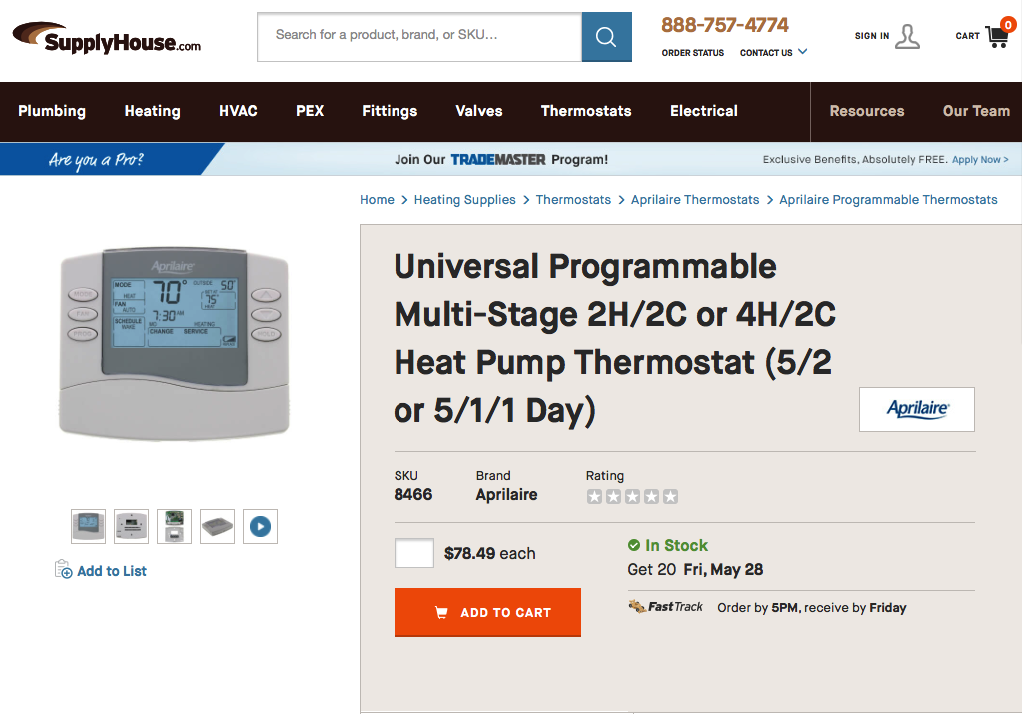

I have PRO T855 thermostat for my HVAC system. It's been replaced twice and it's not working again. I'm tired of them replacing it with the exact same thing. The first two times it was under warrantee. Now it's gonna cost me. I might complain enough to get them to do it again for free, but then again, they might not. More important, I'm sure that the next one will stop working too, and I'd like to find something better.
What's a good replacement Thermostat for a PRO T855?

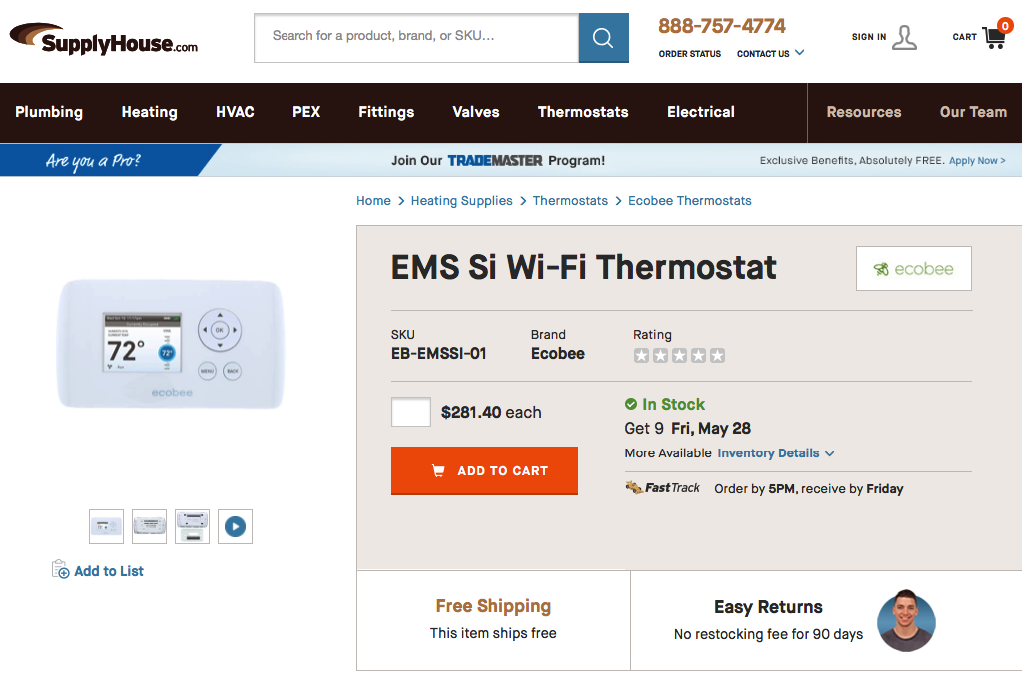

Honeywell TH832 wifi is a cool t-stat if you want to use, check and control with your phone, but the best wifi t-stat out there is the Ecobee IMO.
Aprilaire makes a great basic cheaper thermostat than Honeywell IMO. If I wanted somewhat simple (people get afraid of all the buttones LOL) and price competitive, it would be a 8466

Thank you for your advice and suggesting Aprilaire. I ordered it from Amazon and it arrived yesterday. It took a lot longer to get here then expected, but that seems to be the new normal for a lot of things. Installation was pretty simple. Almost instantly, we noticed a huge difference. For whatever reason, the previous one wasn't doing a good job of removing the humidity. Now we are very comfortable inside our home!!!!
