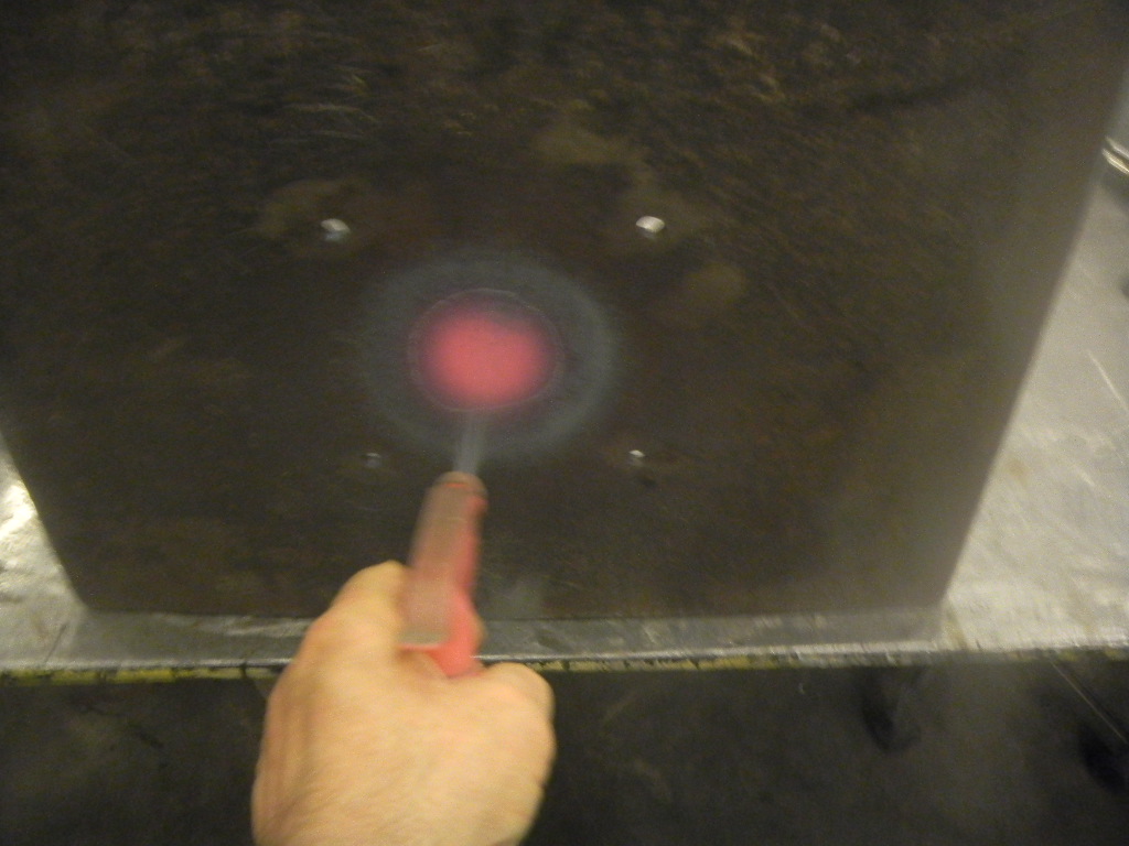

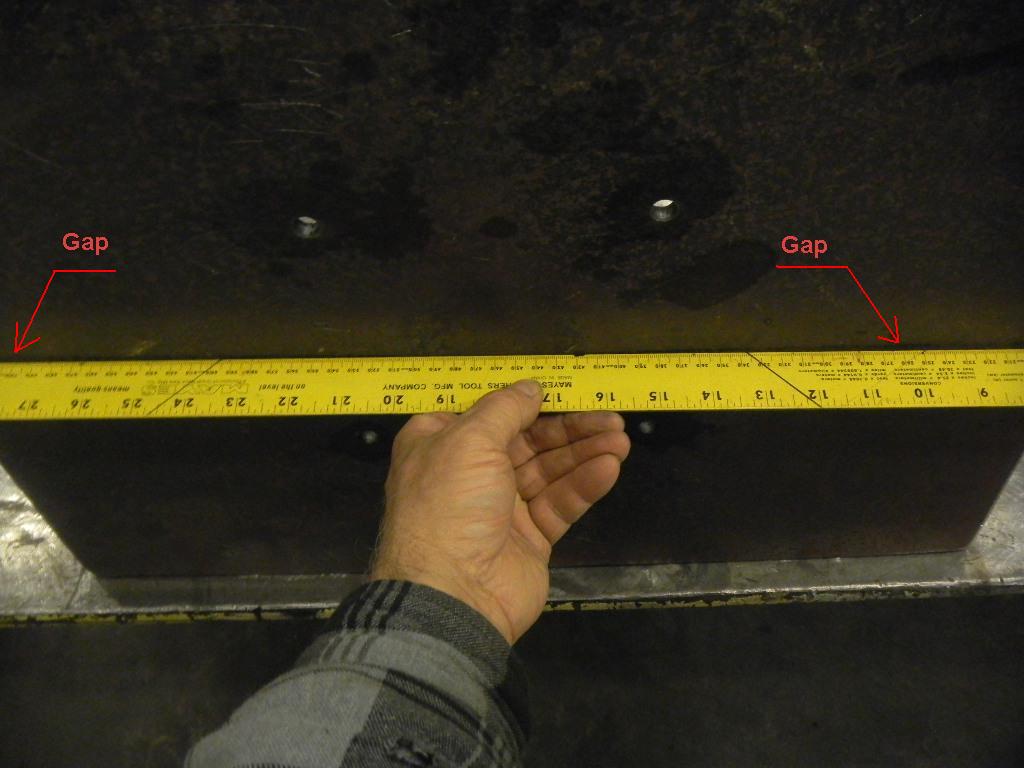

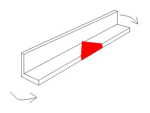

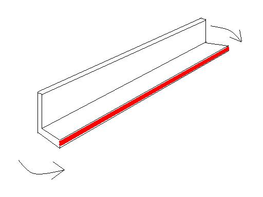

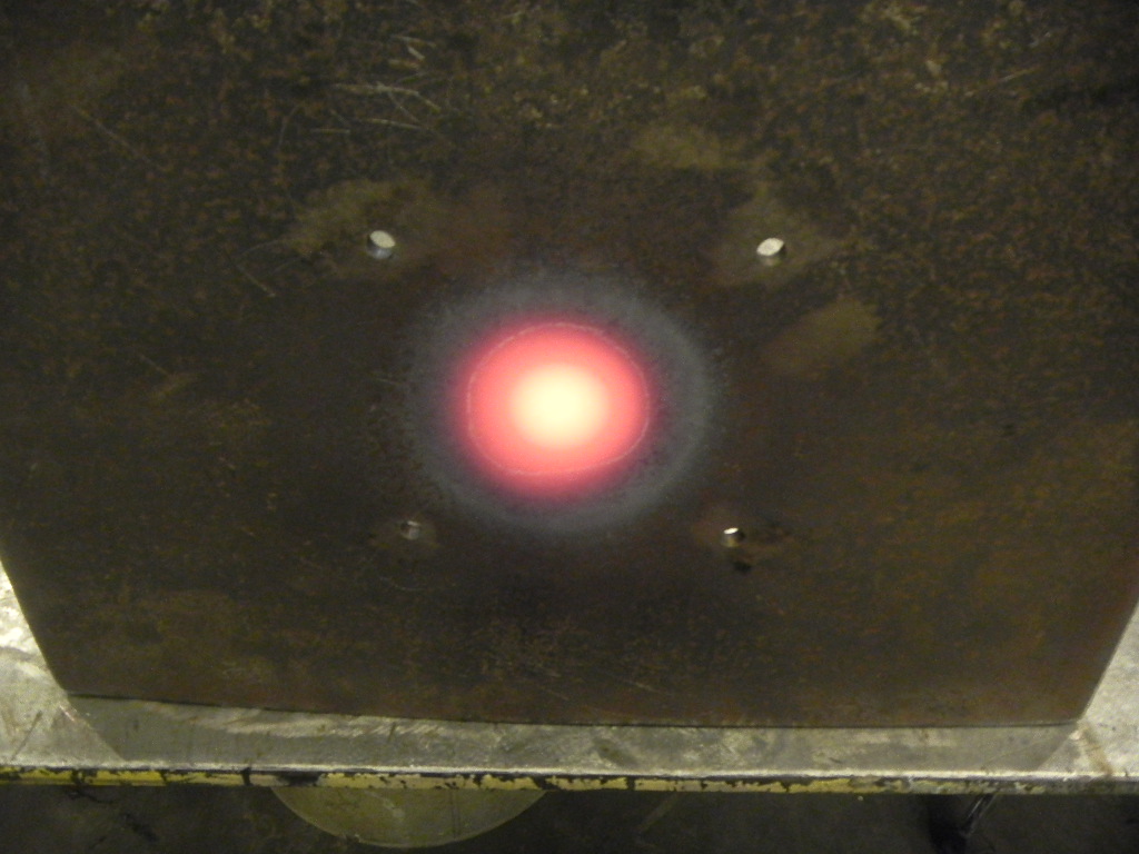

Thank you Shield Arc... I'm so new to welding that the only torch I own is a propane silversmith type torch... I'd need an acetylene torch to heat shrink thick stock, is that right? And the sketches you sent, it's the red colored areas that get the heat and you just heat them until the level bubble hits the middle, (but then as it cooled, wouldn't it return to out of plumb?)Thanks
   / Acceptable Stress in final welds for mild steel #6
I like to use oxygen & acetylene torch for heat shrinking. Most of the time I just use a cutting tip. For really thin material I'll use a welding tip. For large beams I'll use a rose bud.
Yes heat the red area. You can let it cool by it's self or spray water on the heated zone to speed things up. No, once you heat something, and it cools it moves, then stays there. The technique is easy, the trick is, how much heat to apply!
