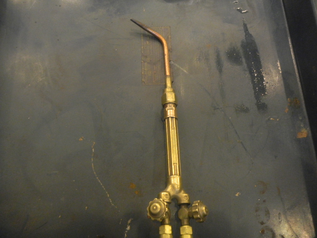

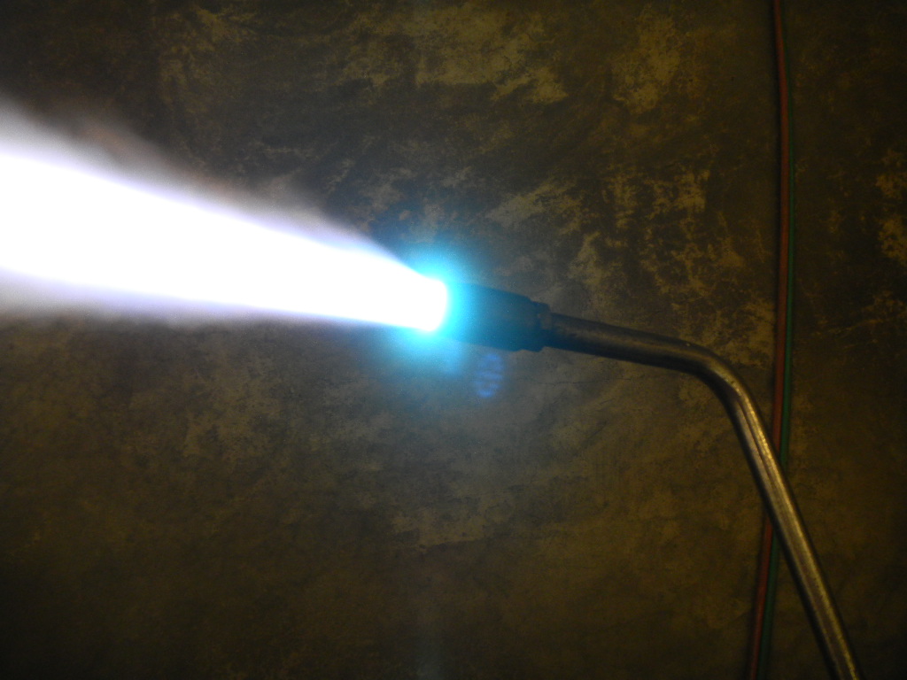

1. Welding tip.
2. Cutting tip.
3. Rose bud.;)
   / Acceptable Stress in final welds for mild steel #12
I like to use oxygen & acetylene torch for heat shrinking. Most of the time I just use a cutting tip. For really thin material I'll use a welding tip. For large beams I'll use a rose bud.
Yes heat the red area. You can let it cool by it's self or spray water on the heated zone to speed things up. No, once you heat something, and it cools it moves, then stays there. The technique is easy, the trick is, how much heat to apply!
I've seen a couple guys automatically cool with the water when they didn't need too. The movement won't come right away. It will start to move while cooling off and may take a minute or two to see the results. There's probably a temperature range when it's cooling that makes the most difference but I don't know what it is.
