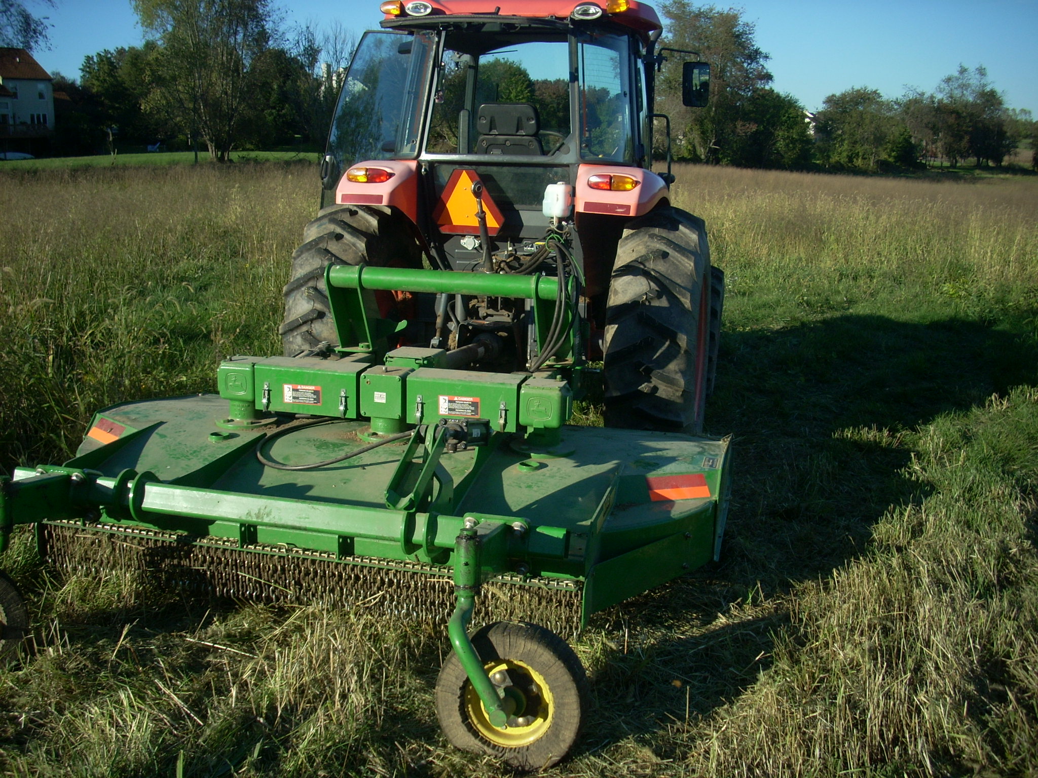

6) By the way, I'm a little puzzled: You mention an 8ft bush hog ? 8ft hogs are not common. Also 8' finish mowers are usually gang mowers or multiple units of some sort.
See John Deere MX-8 below. Around here 8' mowers are very common. Finish mowers are usually 7' or 7.5'.
