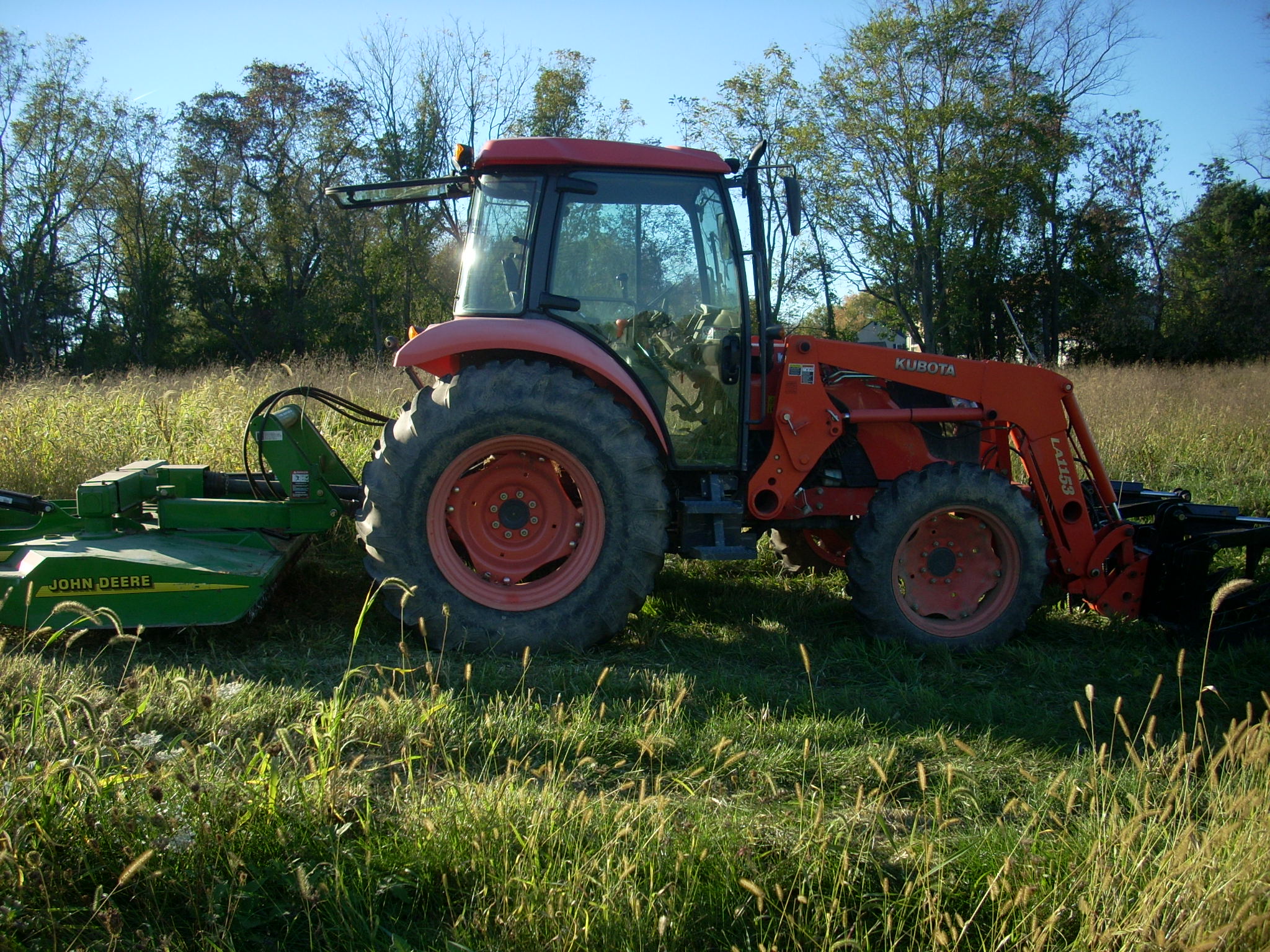

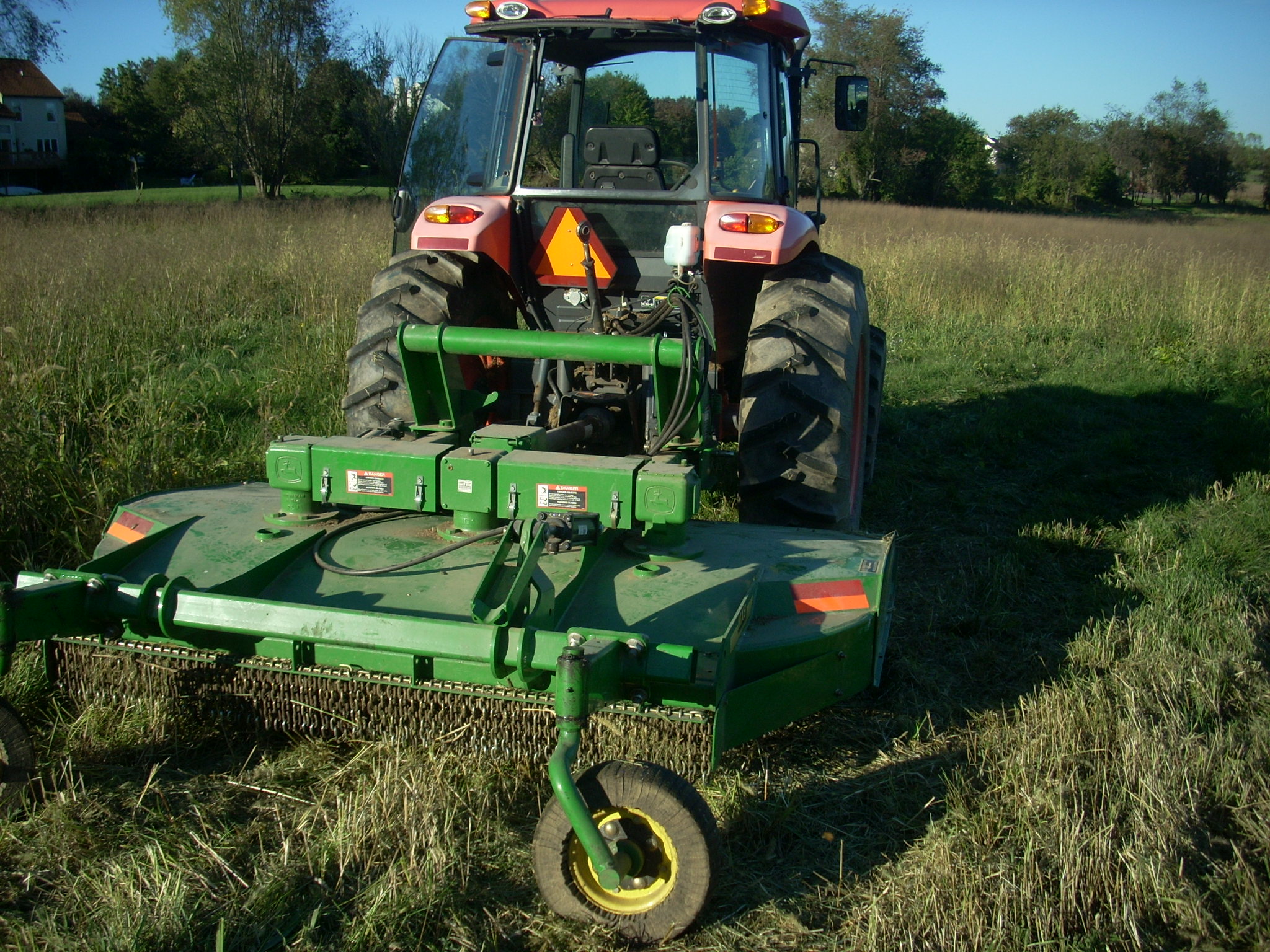

Perhaps a little backround. This is not my first customer. I have several larger parcels I already cut, but only one is a "finish" cut of 9 acres. I do this with my BX2200 because it's too tight and tree laden for a bigger tractor. The above described 20+ acres is all finish grass.
6) By the way, I'm a little puzzled: You mention an 8ft bush hog ? 8ft hogs are not common. Also 8' finish mowers are usually gang mowers or multiple units of some sort.
See John Deere MX-8 below. Around here 8' mowers are very common. Finish mowers are usually 7' or 7.5'.
7) What kind of land is this ? Hilly, flat, rocky, heavy growth in an area with lots of rainfall ?
open, but rolling with average mid-atlantic rainfall.
